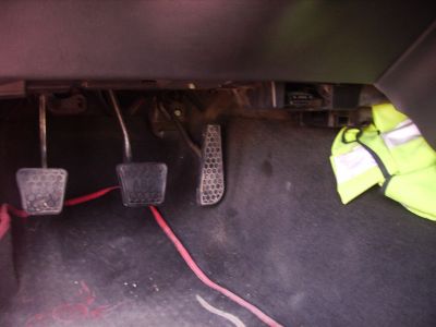

it arrives at the right next to the pedal sees the Connector.

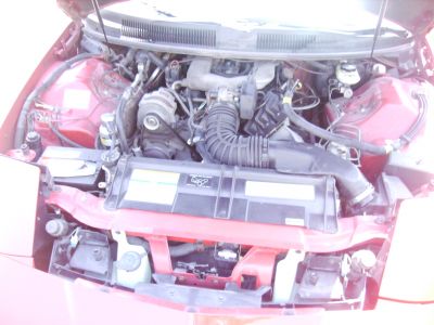

After leaving the car the factory, after making change of oil and filters light SERVICE ENGINE SOON no longer ignites but it has symptoms such. When I take the perfect car in the morning the first 15 minutes but later it is extinguished when it wants gives pulls, not that to do. Here down you have a photo of the motor but it is of little aid.

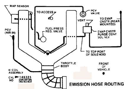

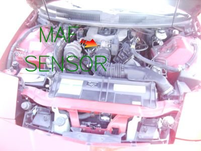

You can try unplugging the MAF sensor and driving the car, or unplugging the MAP sensor and driving the car.
Usted puede tratar de desenchufar el sensor MAF y conducir el coche, o desenchufar el sensor de MAPA y conducir el coche.

https://www.2carpros.com/forum/automotive_pictures/30961_firebirdvac_1.jpg
need good vacuum.

The sensor that you showed to me in the previous photo, disconnects it, and when it takes the car it was accelerated to 2000 revolutions.

Disconnected the maf sensor?
Electronically, with the electrical connector correct?
Clean the sensor
