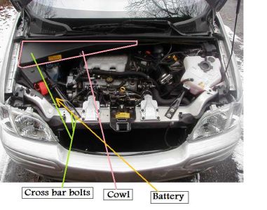

I thought my starter was going bad. Sometimes I would turn the key and the van would do nothing. My boyfriend would bang on the starter and usually it would start. The last time it happened he banged on it and we made it home. But the whole way home the battery light was on in the little box on the dash. The van been sitting since. Im asuming that the battery light means that I need an alternator. But I thought when the starter went bad that it would make a noise when you tried to start it and not just do nothing at all. So do I need a starer and an alternator or is there maybe some other reason for the way the van has been acting

GM is known for many common problems among a lot of cars. One of them is the side terminal batteries manufactured by AC Delco. In short they leak, leak, leak. When this happens the contact to the battery cables is severed but not usually before it leaks into the cable several inches and requires replacing both parts.
You will need an 8mm box end wrench, the longer the better to check. After unscrewing the bolt, remove the red insulator for the positive terminal. There, you will probably find a lot of whitish green powder; that is the corrosion. With a wire brush and baking soda w/water, clean it as much as possible. Allow a few minutes to dry.
To replace the battery, there is a 13mm bolt that holds a bottom lip to the ledge underneath it. Once this is removed the cross bar above the battery will have to be removed as well. I think the two near the front are 13mm and the one near the window under the cowl is a 15mm.
https://www.2carpros.com/forum/automotive_pictures/435113_Untitled_2.jpg
It's a tight fit, but can be done with a little patience. BTW use gloves when handling the battery and cleaning the terminals. Avoid eye, skin and clothing contact.
If this is the problem with your vehicle it should be performed before the alternator and starter are tested. Neither f those systems can be tested effectively unless the battery and cables are in good working order.
