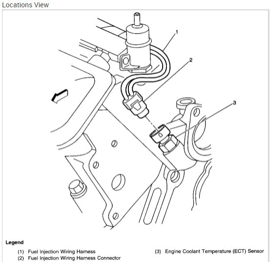

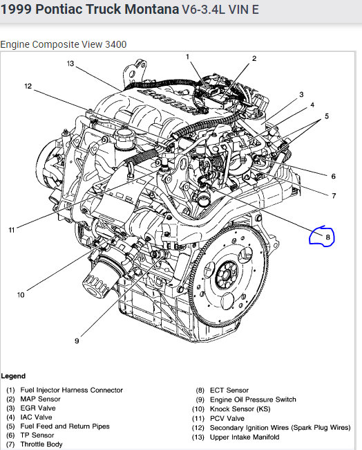

Need the location of the temp sensor.
Thursday, March 11th, 2010 AT 3:04 PM
SQM
MECHANIC
6,383 POSTS
Please see attached for the location diagram of the temperature sensor.
