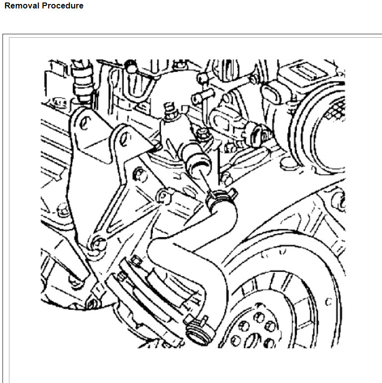

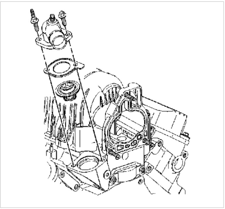

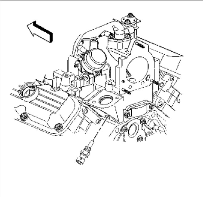

temperature gauge quit working. It still cycles on and off when you first crank the car. Then stays in the off position.
May 11, 2009 at 9:33 PM
  • CAR REPAIR CONTRIBUTOR
  • 54,354 POSTS
It sounds like one of two things maybe happening. Fist is the temperature gauge is working fine and it is a thermostat that is stuck open causing the engine to run cold or you have a temperature sensor that has gone out.
Here are guides to help us confirm the problem and get it fixed.
and
https://www.2carpros.com/articles/coolant-temperature-sensor-cts-replacement
Here are how the jobs are done on your car (below)

When sitting and warming up the car will not warm up inside. When driving it will start to warm up. The temp gauge gets a little bit above half way but doesn't go any hotter, when driving the gauge goes back down and the heater starts to work. No smell of antifreeze or anything and it may just be ironic (have no idea) but the seat warmers won't work either.
Jan 4, 2018 at 4:49 PM (Merged)
WRENCHTECH
  • 20,761 POSTS
You may have air in the system or the heater core could be plugged up from Dexcool gone bad.
I would flush the whole system and install a new thermostat. Pull the hoses off the heater core and flush that in both directions thoroughly with a garden hose under pressure.
