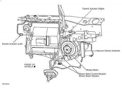

WATTS_AMAN
  • 15 POSTS
The resistor is located just forward of the blower motor its self. 3 screws only lossen the 2 forward ones, remove the aft one and slide towards you. If your Fan doesnt work on high I dont believe it would be the resistor. High goes straight to the motor relay and then to the blower motor. Just suggesting it sounds like you may need a new blower motor.

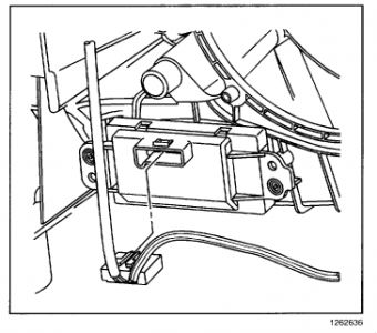

JWERK24
  • 16 POSTS
Where is the resister located on a 2001 g.P. 3.1liter?
Tuesday, August 14th, 2018 AT 3:04 PM (Merged)
  • 75,992 POSTS
Here you go
https://www.2carpros.com/forum/automotive_pictures/12900_blower_resistor_13.jpg
