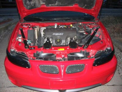

I have put a new computer system in this car because I was told there were a few bad sensors. My car seems to be getting worse every day and it quits going down the espressway but then starts right back up usually. There are several times in a week that it wont start and when it does start it seems as if it wants to chug when going up a hill or even just stepping on the gas. There has been a new air flow mass sensor put on also and when unplugged, the car still runs the same. I have put hundreds into this car and now have been told that there is no way my car needed a new computer system by several mechanics. I am being taken for a ride and Im getting upset. Do you have any clue what this could be? Someone siad posisbly a fuel pump but why would it just run crappy instead of just simply quitting, its been doing this for several weeks.

CDUBZ420
I had the same exact problem with my car (2000 pontiac GP GT 125000 miles) . i replaced the fuel filter first and it didnt fix the problem. then i replaced temp sensor & thermostat. these didnt work either. replaced alternator it was bad anyway and this didnt fix the problem. i was told it could be the crank sensor causing this problem . i didnt change it but it wasnt the problem. the problem was bad gas i would go up hill it would suck water up and stall. same situation going down hill (usually when i had a quarter tank or less) . this wasnt a constant problem but atleast once a day. i switched gas from get go to exon and now car runs fine with no problems. try putting better gas and fuel injector/ water remover in your tank this just might help your situation. and the way i looked at it was all the stuff done to it needed done anyway so tht was just a plus.
