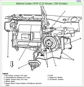

I have attached the info you requested. . .you didn't specify which engine size so I went with a 3.8L VIN K. . ..(the VIN is the 8th digit of your VIN number)
I gave you the procedure on blower motor replacement. You most likely cause for the fan speed is the blower resistor is bad. I have also provided that for you.
https://www.2carpros.com/forum/automotive_pictures/248015_Picture1_12.jpg
Blower Motor Notes
Remove or Disconnect
Battery ground negative cable.
Right side instrument panel insulator.
Blower motor cooling hose.
Blower motor electrical connectors.
Blower motor mounting screws.
Blower motor.
Install or Connect
Blower motor and mounting screws. Tighten
Screws to 20 N.m (14 lb. ft.) .
Electrical connectors.
Blower Resister
Electrical connectors from blower motor resistor.
Loosen (do not remove) both forward mounting screws.
Blower motor resistor opening is slotted as access is extremely limited.
Rearward mounting screw.
Blower motor resistor. Important
Care must be taken when removing the blower motor resistor. The resistor is a ceramic card for (C60).
Install or Connect
Rearward mounting screw. Tighten
Screw to 1.5 N.m (13 lb. in.) .
Tighten both forward mounting screws. Tighten
Screws to 1.5 N.m (13 lb. in.) .
Electrical connectors to blower motor resistor.
