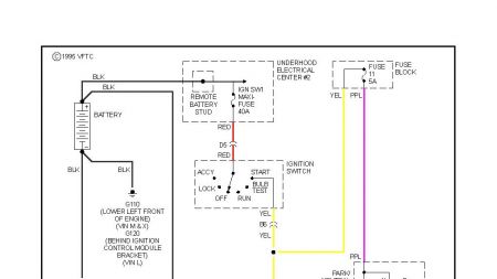

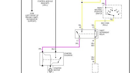

Key won't start motor. No reaction when key turned into the start position. Starter checked and is good, and there is no power going through the wire when key is turned. Fuel pump is not coming on when key is turned to the on position, and the ignition switch has been replaced. Engine will not start when starter is manually engaged and I do have spark on the spark plugs

No starter cranking -could be the fuse no.11 5amp,theft deterrent relay, park and neutral position switch, and ignition switch.
Fuel pump problem -check fuel pump fuse and fuel pump relay.
https://www.2carpros.com/forum/automotive_pictures/12900_p1_2.jpg
https://www.2carpros.com/forum/automotive_pictures/12900_p2_2.jpg
