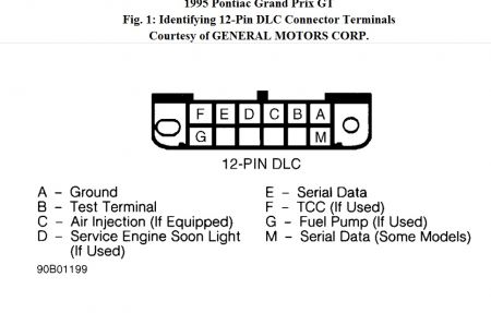

If you are fully obd1 compliant, 12 pin datalink connector, under lower edge of dash. Check for mil codes. Use jumper wire between A & B terminals at data link connector, key on, no crank. The mil starts flashing, you count the flashes to get the codes. Your looking for two digit codes. Also, use a gage and check fuel pressure, some of the national brand autostores used to loan out a gage, if you don't have one. Without more information, all I can do is hunt and peck.
https://www.2carpros.com/forum/automotive_pictures/170934_grand_prix_data_link_connector_1.jpg
