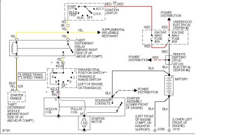

i replaced the stater and the battery and it still start

I'd check all applicable fuse circuits for voltage. Did you try cranking in neutral? What about your theft/security system, do you have the pellet in the key, try a different key.
https://www.2carpros.com/forum/automotive_pictures/170934_grand_prix_starter_circuit_1.jpg
