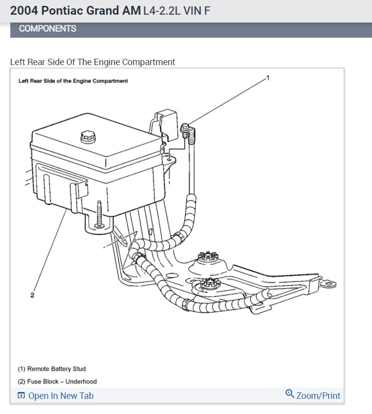

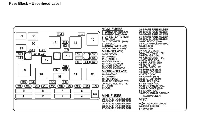

My car won't start. I have no fuel pressure. Can you tell my where the fuel pump relay and the fuel pump inertia switch are located in my car? I would like to check these before buying a new fuel pump

Do you hear the fuel pump come on for a few secs? If not here is a guide to help check the relay with the relay location #18 in the diagrams below.

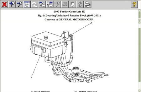

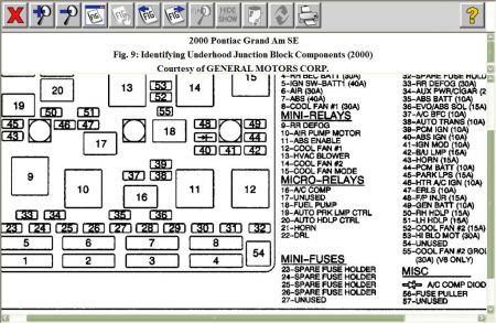

The fuel pump relay is located in the junction block and the fuse for the fuel pump is no.18 see below-
https://www.2carpros.com/forum/automotive_pictures/12900_junction_block_1.jpg
https://www.2carpros.com/forum/automotive_pictures/12900_fuel_pump_11.jpg
