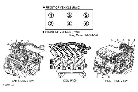

I took each wire off the plug and put it on a new plug and looked at the fire the code reads the cyl in the back center misfire but it is fireing the only thing I havent checked is that injector on that cyl because you have to remove the intake cover all the plugs are new also wires one could be crossed do you have the fireing order
Wednesday, July 29th, 2020 AT 10:08 AM
2CARPRO JACK
  • 11,533 POSTS
Yes, but htere is no way to cross just one, it would have 2 off and would run very poorly.Does it misfire at idle but is ok at higher rpm?
