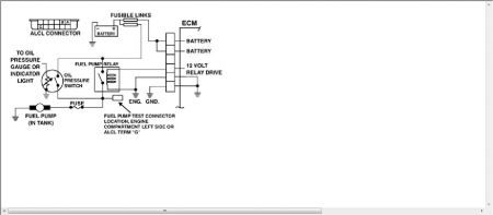

2001 Pontiac Grand Am 4 cyl Front Wheel Drive Automatic
what wire is pos and what one is neg on the fule pump

Gray is fuel pump power and black is ground. It only powers for 2 seconds after the key is turned on.

Gray is power and ground is black

The solid black is ground wire, the purple goes to fuse block, the grey wire (power wire) runs to fuel pump relay and the black/white wire runs to the PCM and fuel pressure sensor.

After that 2secs while engine cranking and builts an oil pressure above 4psi the fuel pump and oil pressure sending unit takes over command on the power.
