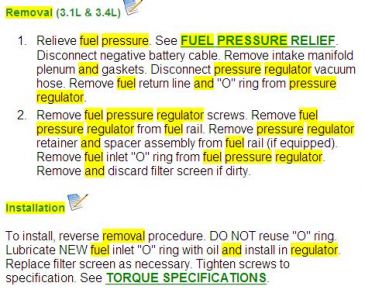

2000 Pontiac Grand Am fuel pressure regulator

I was wondering if anyone can help with directions on how to change out my fuel pressure regulator on my 2000 grand am se with the 3.4L engine?

Welcome to the forum. MOD shows this procedure.
https://www.2carpros.com/forum/automotive_pictures/170934_grand_am_pressure_regulator_1.jpg
