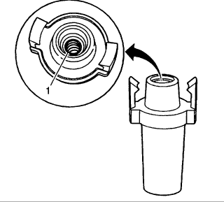

Condition
Some customers may comment on a rough engine idle and/or misfire. The Check Engine Light (CEL) may or may not be illuminated, and DTC P0300 may or may not be set under rough idle conditions.
Cause
Condition may be due to a missing spark plug boot spring.
Correction
https://www.2carpros.com/forum/automotive_pictures/248015_1_8.gif
Legend
(1) Spark Plug Boot Spring
https://www.2carpros.com/forum/automotive_pictures/248015_2_9.gif
Check for presence of the spark plug boot spring (1) by removing each boot and checking for spring presence at the boot to coil tower connection If the spring is missing, replace the spark plug boot assembly

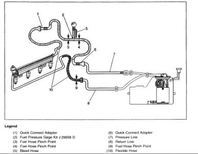

https://www.2carpros.com/forum/automotive_pictures/248015_78554887_1.jpg
FUEL PUMP PRESSURE
With the ignition switch "ON" and the fuel pump "RUNNING", the fuel pressure indicated by the fuel pressure gage should be:
With EGR 284-325 kPa (41-47 psi).
Without EGR 358-405 kPa (52-58 psi).

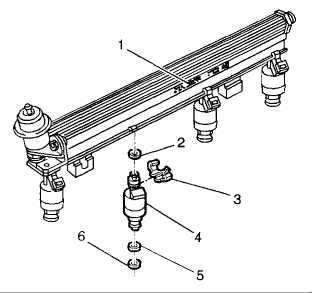

https://www.2carpros.com/forum/automotive_pictures/248015_2_11.gif
REMOVAL PROCEDURE
Relieve the fuel system pressure. Refer to Fuel Pressure Relief Procedure.
Remove the fuel rail assembly (1) from cylinder head.
Spread the fuel injector retainer clip (3) to release the fuel injector from rail extrusion flange. NOTE: Use care in removing the fuel injectors in order to prevent damage to the fuel injector electrical connector pins or the fuel injector nozzles. Do not immerse the fuel injector in any type of cleaner. The fuel injector is an electrical component and may be damaged by this cleaning method.
Remove the fuel injector assembly (4).
Discard the fuel injector retainer clip.
Remove the injector O-ring seals (2) (6) from both ends of fuel injector, and discard.
INSTALLATION PROCEDURE
CAUTION: In order to reduce the risk of fire and personal injury that may result from a fuel leak, always install the fuel injector O-ring in the proper position. If the upper and lower O-rings are different colors (black and brown), be sure to install the black O-ring in the upper position and the brown O-ring in the lower position on the fuel injector. The O-rings are the same size but are made of different materials.
IMPORTANT: Different fuel injectors are calibrated for different flow rates. When ordering new fuel injectors, be sure to order the identical part number that is inscribed on the old fuel injector.
Lubricate new fuel injector O-ring seals (2) (5) (6) with clean engine oil and install on fuel injector assembly.
Install the new fuel injector retainer clip (3) on fuel injector assembly. IMPORTANT: Position clip on right side of the fuel injector electrical connector.
Install the fuel injector assembly (4) into fuel rail injector socket with electrical connector facing outward. IMPORTANT: Push in far enough to engage retainer clip over rail extrusion flange.
Install the fuel rail assembly (1).
