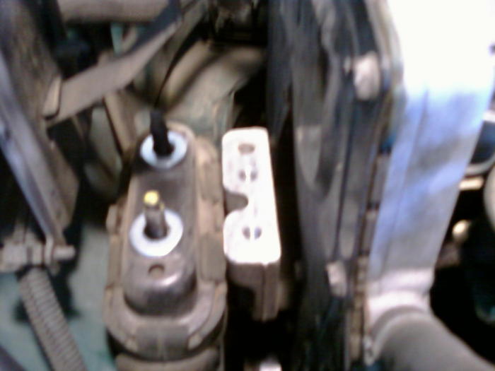

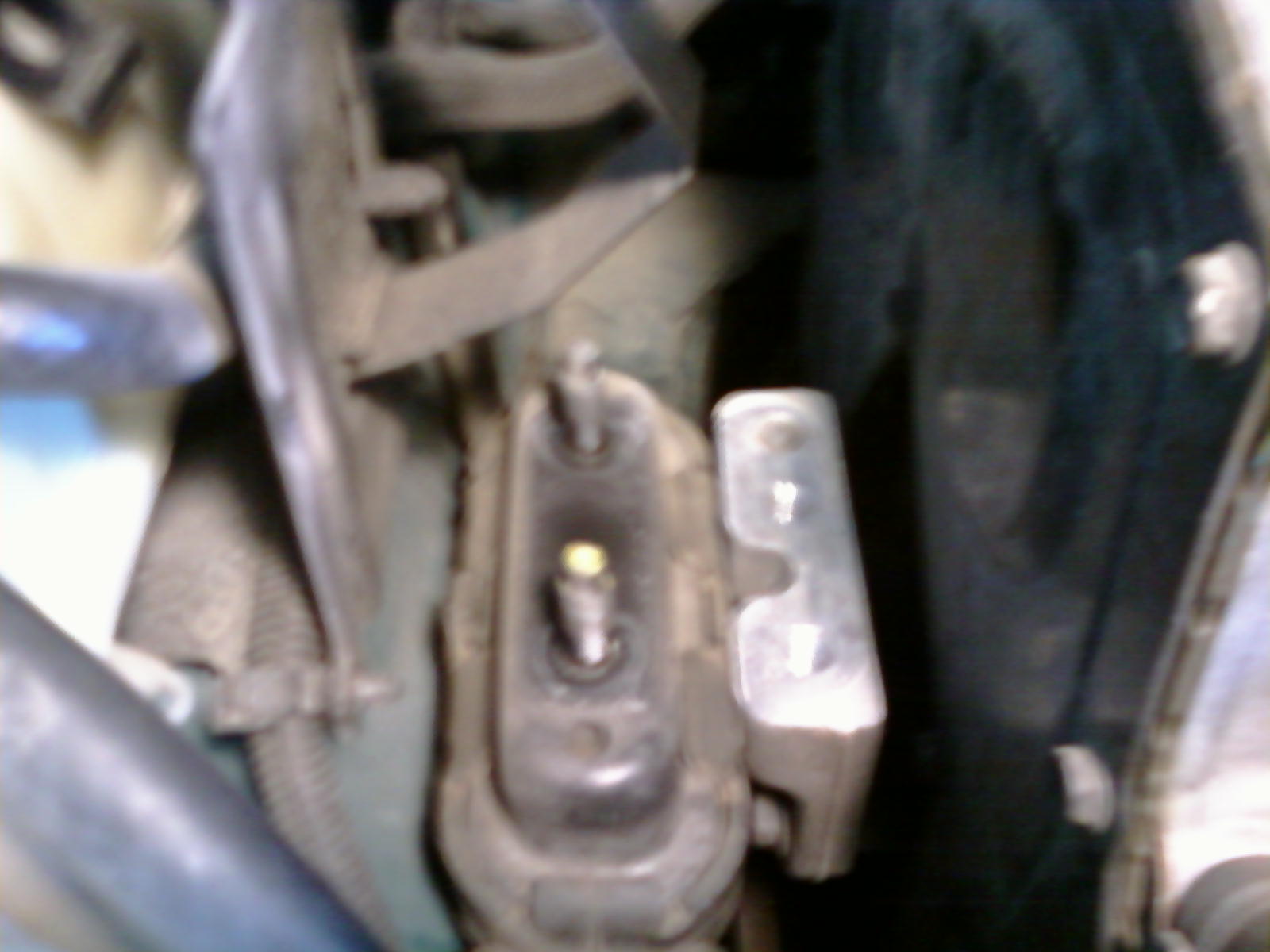

Alright, new pictures.

Another where the washers go.

Okay, after doing the job, which only took like fifteen minutes like you said, the vibration still exist and hard to tell if it is better. I just put one half an inch flat washer because when I put two I did not feel comfortable with the amount of threads for the bolt to catch. I also did assume you were talking about metal washers and not rubber. You may have mentioned that but that is where I stand as of now. Let me know if you have anymore feedback. Thanks

I would try two, three, or even four washers on each stud, just to see if we are on the right track. Do this in progressive steps, one more pair at a time. What this fix does is to compensate for the natural age compression of the rubber in the motor mount. Years of having the weight of the engine sitting on the rubber causes it to eventually compress. Do not worry about the amount of threads for the nuts to engage for now. For example, if you find that three washers on each stud cures the vibration, you know that you have pinpointed the problem. At that point, you have basically three options.
1. Leave things as they are, and do not worry about the thread engagement. Locktite the nuts in place, and run it. The engine weight is pushing down on the mounts, not pulling up on it, so the nuts are not doing very much work anyway. (Unless you roll the car upside down, and then you have bigger things to worry about than the engine falling out.)
2. Replace that motor mount. However, this might not cure the problem, since the driver's side has probably compressed with age also. That one does not look to be very easy to replace. At that point, you could still go with the washers, and you might need less than before, since the new mount is not compressed.
3. You may be able to unbolt the mount from the body, and place the washers under the mount rather than on top of it. I have not removed that mount, so I am not sure how it is fastened to the body, or if the washers would work under it. It would probably be better to use a piece of flatstock steel of the right size and thickness instead of washers under the mount. The washers may concentrate all of the weight on too small of an area on the body under the mount, and eventually cause it to bend or crack. Remember the body subframe is just sheetmetal bent and welded together to give it structural strength. This is not a problem on the top of the mount, since the bracket is made from much thicker material.
Let me know what you find, and I will see if I can come up with any other alternatives.
