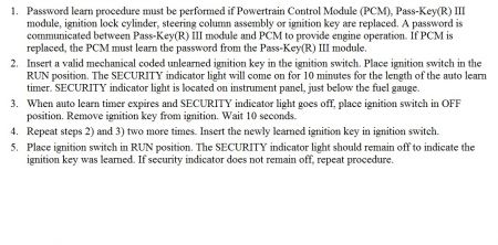

have 98 grand am starter went south so I had it rebuilt and put it back on now it wont start. Starter works fine turns the engine over. Just wont start checked all the fuses they seem fine. Fuel pump is running fuel to the fuel rail just not past the injectors. What could it be to keep injectors from working. Ran fine before the starter was changed. Just took a lil bit to get the starter to engage and turn over engine

Sometimes if battery voltage is lost, it may go into theft lock? Is the security lamp on or flashing when you try to start? You can try password relearn procedure, don't know if it will help?
https://www.2carpros.com/forum/automotive_pictures/512072_antitheft_password_relearn_1.jpg
