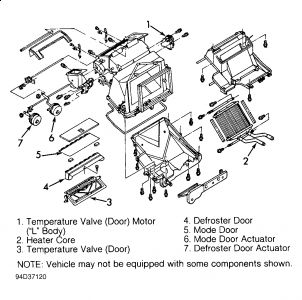

i had to change the motor.I also changed the heater core at the same time. Now the car has very little heat, the heater hoses are hot but the output is luke warm. Any ideas?/

Are both heater core hoses hot? If so, may be blend door:
https://www.2carpros.com/forum/automotive_pictures/108325_GA_heater_1.jpg
Did you check coolant level?
