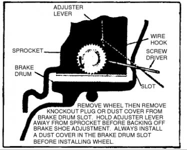

I need a copy of a diagram for the entire braking system from the master cylinder to the wheels
Thursday, April 22nd, 2010 AT 11:36 AM
29 Replies
MECHANIC
108,310 POSTS
I do have a schematic, I can tell you. From the master cylinder, two lines go to the ABS module. From there, you have lines that go to the proportioning valve. Then you have one to each front tire, one to each rear wheel cylinder (or caliper if you have 4 wheel disc). Here is what we have in the diagrams. Check out the diagrams (Below). Please let us know if you need anything else to get the problem fixed.
