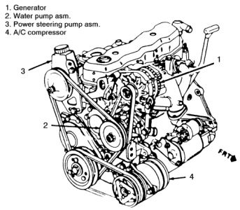

My car leaked all the coolant out and I was told that a timeing chain could be in the wayy of the pump or hose because I waas told that one of them are the cause for the leak is this ture?

No the only thing that would possibly be in the way of your water pump would be your alternator here is a picture
https://www.2carpros.com/forum/automotive_pictures/331027_pic_1.jpg
is picture to small to make out? if so send me your email addy and i'll send it that way so you can zoom in and out
