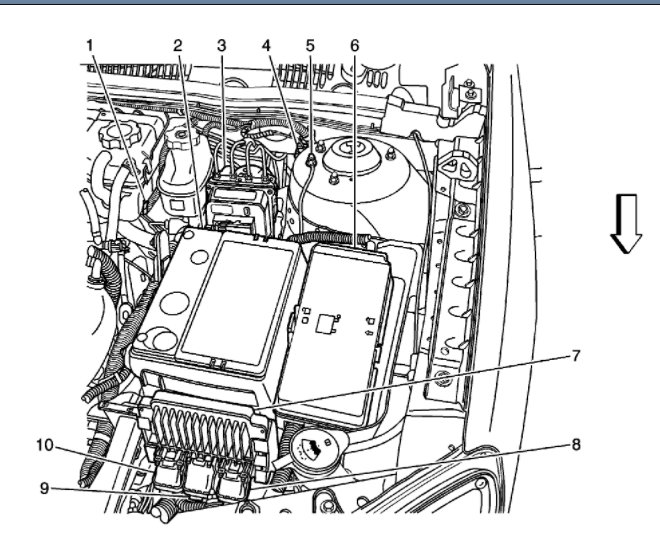

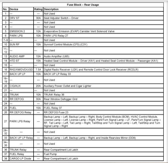

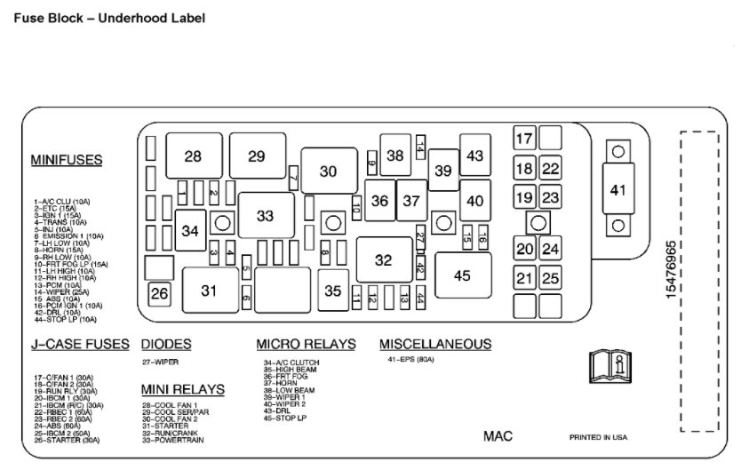

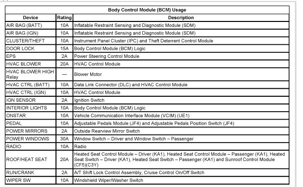

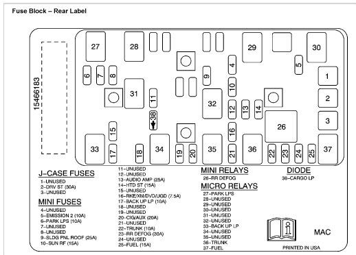

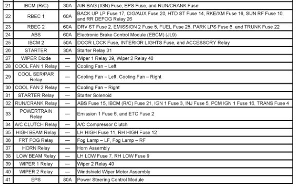

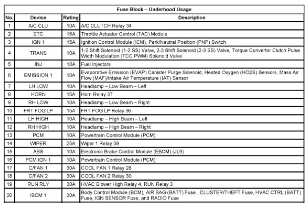

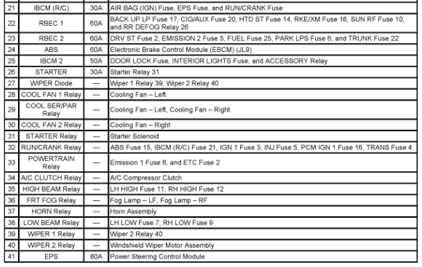

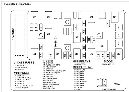

I have not lights in the rear I need to check some fuses where are they and how do I check them?
Thursday, October 16th, 2008 AT 3:02 PM
DANNY L
MECHANIC
5,648 POSTS

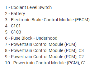

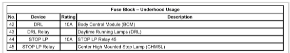

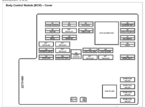

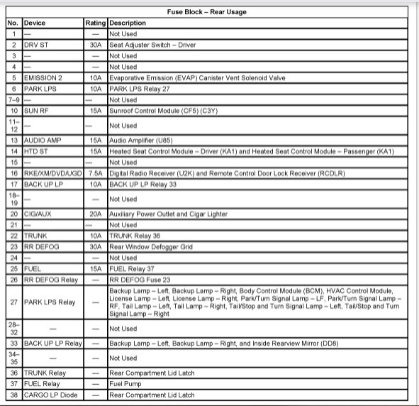

Hello, I'm Danny.
Here is the information you requested. Here are a few tutorials for you to view on how to check and replace fuses:
I've attached pictures below showing the fuse and relay locations on your car. Hope this helps and thanks for using 2CarPros.
