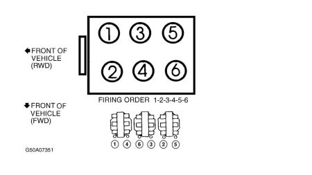

My brother was installing new spark plugs on the car but when he was doing that one of the terminals chipped off and he decided to go to an auto parts store to get a new one and when he was driving over their he felt it would turn off a lot. When he replaced it the car would start and then turn off and it shakes the little time that it is on.I would really appreciate any help

I'm not sure what you got going on? For the 3.4L sparkplug- ac-R43tsk, 045 gap. Firing order is below. Check for any applicable trouble codes. You have spark at all the plugs, correct?
https://www.2carpros.com/forum/automotive_pictures/170934_firebird_firing_order_1.jpg
