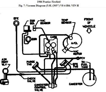

Where can I find a picture of the carburetor vacuum diagram? I can't make out the one under the hood. Please help so we can get this baby smoothed out.

Could you please specify the 8th digit of your VIN so I can post the correct vacuum diagram?

Yes sir, the 8th digit is an H.

Thanks for that info. Below is the vacuum diagram for your vehicle.
https://www.2carpros.com/forum/automotive_pictures/261618_Noname_459.jpg

Thank you, thank you, thank you. This is just what I was looking for.
