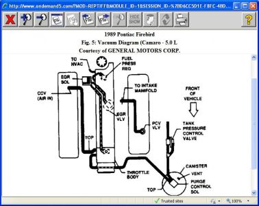

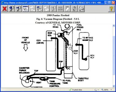

I need a vacuum diagrm for a 305 with a TBI fuel system on it.

They show two differnt ones for that car see which one looks like yours and follow it.
