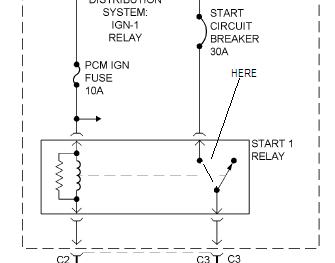

Neither one of those codes would keep the starter from cranking.
https://images.2carpros.com/forum/automotive_pictures/170934_pontiac_bonneville_jumper_1.jpg
If you use a jumper on the terminals for the load side of relay, like the picture, the starter should crank. That does not mean it will start. Make sure the transmission is in park or neutral and the e-brake set. Have somebody check the voltage circuits at the relay. I just wanted to add, if the theft system was causing a problem, the code would probably be a body code.

Okay, I have power and it will crank at the relay when jumped so I R&R the relay and no difference.
Look fellas the engine will crank and run. After I turn the key to ignition I have to wait approximately two to three minutes to crank and like clock work the engine cranks over and runs. Now if I wait approximately ten minutes or more the engine will not crank and run. I have to again wait two to three minutes for the engine to crank and start, it will do this time and time again.
Now I may assume that the problem is in the serurity system, if so my scan tool can not do body codes.
So I guess I need one that can do body codes or find someone that has one to do this scan.

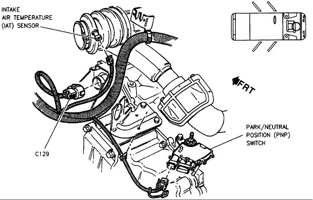

MELISSA FLAUGHER-RATCLIFF
Where is the neutral safety switch located? Car will not crank. Starts sometimes and it is not the battery or the starter.
Jul 2, 2018 at 11:38 AM (Merged)
CJ MEDEVAC
  • CAR REPAIR CONTRIBUTOR
  • 11,004 POSTS
This is what it looks like:
http://shop.advanceautoparts.com/p/bwd-neutral-safety-switch-ns38003/20971213-P?searchTerm=back-up%2Fneutral+safety+switch
On the side of the transmission.
Have you tried to start it in 'neutral'?
The Medic
Yes, we have tried everything. Thought it was the crank sensor but it is not. Where the neutral safety switch is suppose to be its not there. About to give up.
CJ MEDEVAC
  • 11,004 POSTS
I could not find a diagram in 'Prodemand', I searched quite a while on the net.
Seems it is also called a 'PNP'
Diagram below, I hope it helps.
The Medic
