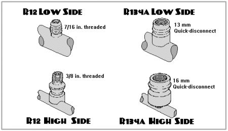

Where is the LOW pressure ac port
Thursday, July 2nd, 2009 AT 6:26 PM
MECHANIC
75,992 POSTS
Dunno but here's a guide to find it
Look for these test ports within the AC piping Yours is R134a system
