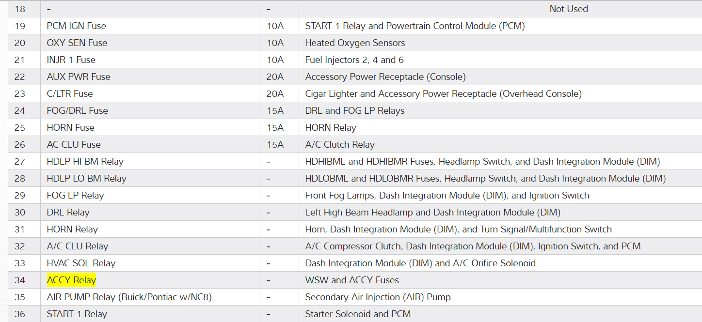

My cigarette lighters no longer work. I assume that iit is a blown fuse but I do not know where the fuse box is located. Also how do I know which fuse to change out.
Thanks
Thursday, December 3rd, 2009 AT 11:18 AM
19 Replies
  • 110,194 POSTS

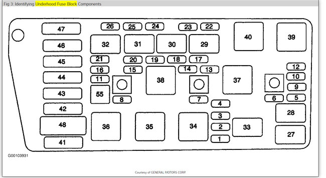

Here is a guide to help you test the fuses and the fuse panel diagrams listed below.

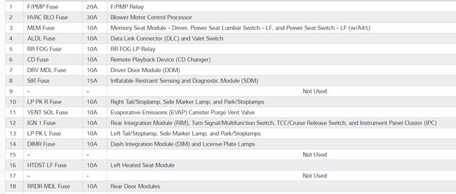

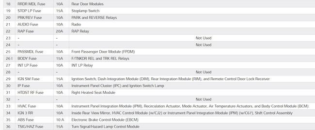

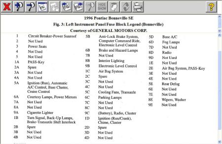

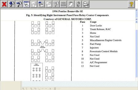

My car is used and the only owners manual with the car was a 1995 manual for a bonneville, so now I need to know what all the fuses go to in the fuse box, because most of the fuses are not there, but my doors lock automatically, when my car sit's overnight. And Ido not know what my fuses go to in the fuse boxatly appreciated. I have no credit card so I am unable to donate any money at this time, but I sure would appreciate your help.
Friday, July 17th, 2020 AT 12:23 PM (Merged)
  • 75,992 POSTS
See below

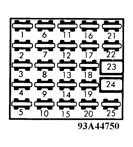

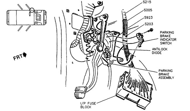

Left I/P fuse block:
https://www.2carpros.com/forum/automotive_pictures/12900_fuse1_1.jpg
Right I/P fuse block
https://www.2carpros.com/forum/automotive_pictures/12900_fuse2_1.jpg

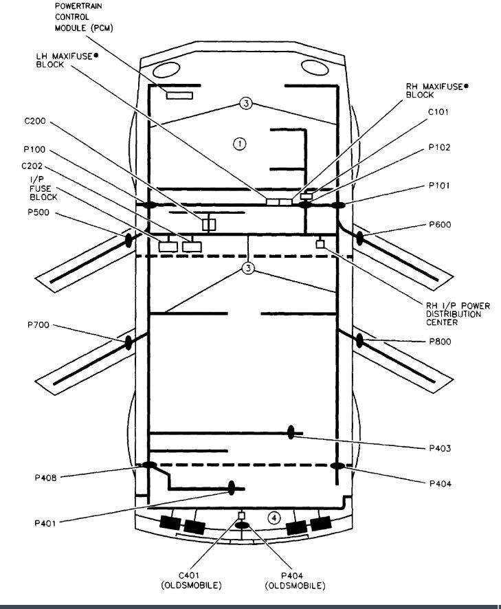

See the diagrams below for the location of the power centers for your vehicle
Let us know if you need anything else

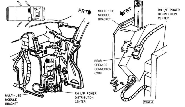

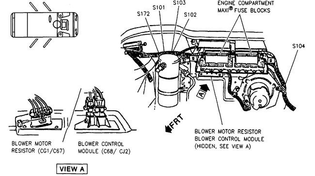

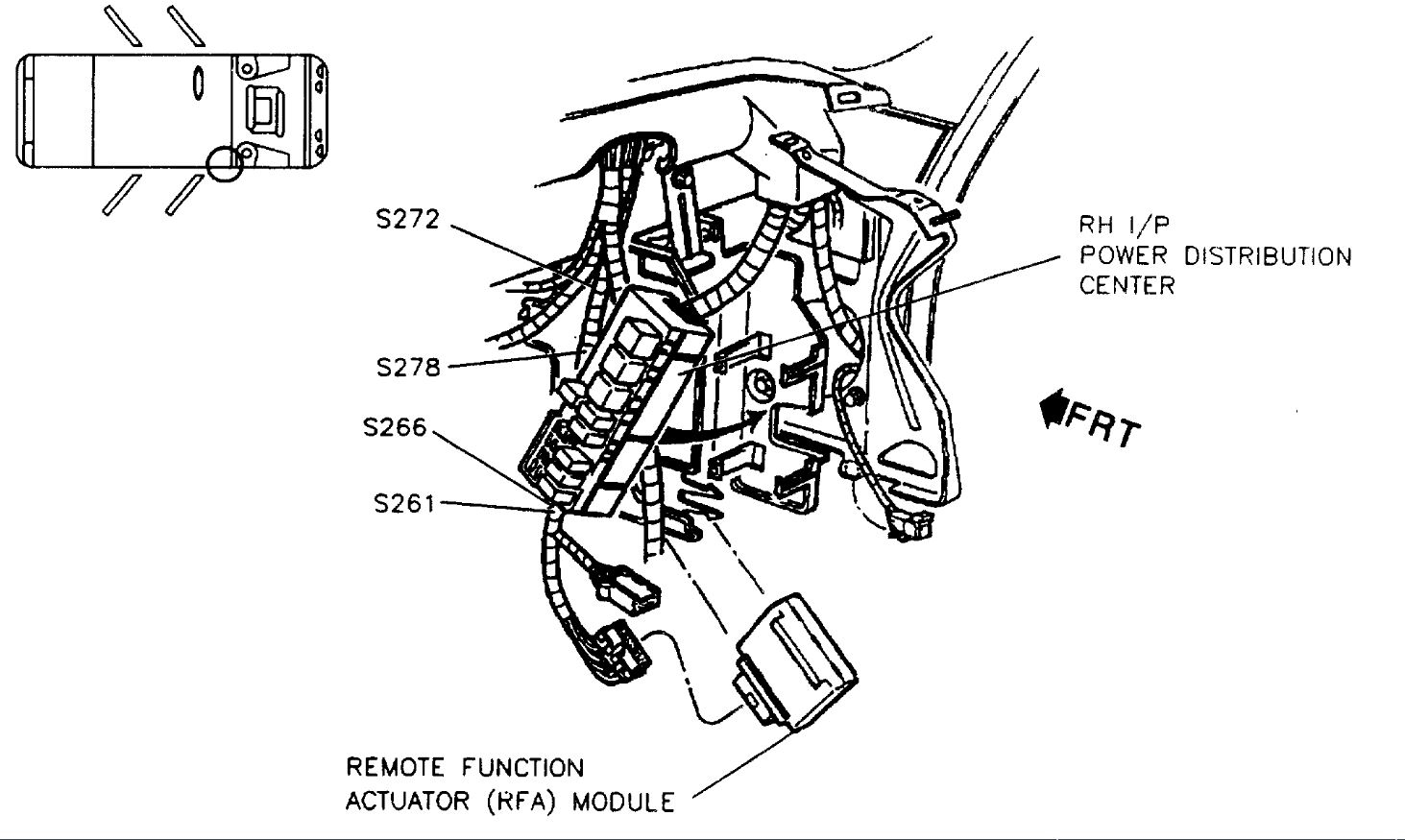

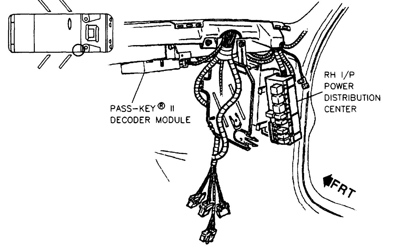

Where is the fuse box located
Friday, July 17th, 2020 AT 12:24 PM (Merged)
2CARPRO JACK
  • 11,533 POSTS

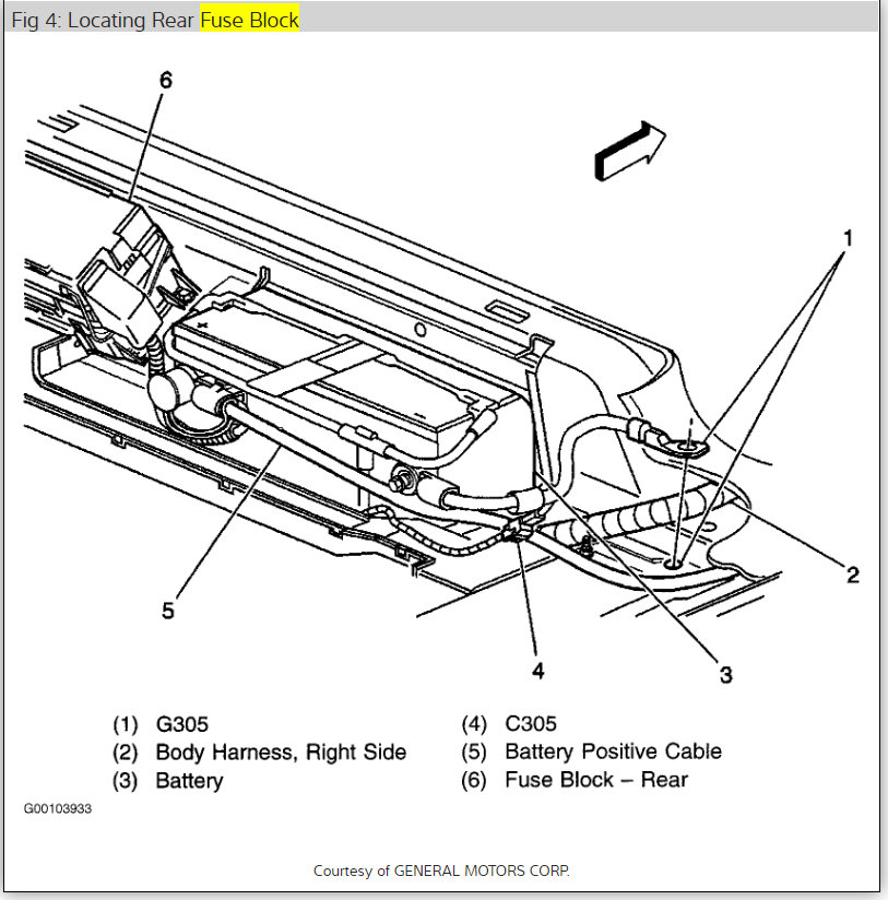

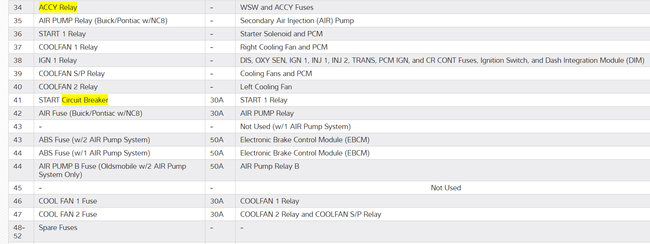

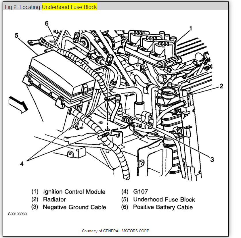

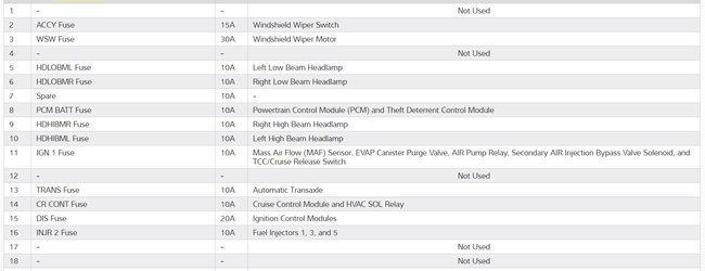

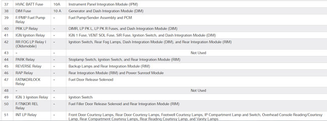

There are several fuse blocks in this vehicle
See the guide below on testing fuses with a test light
See the diagrams below for locations

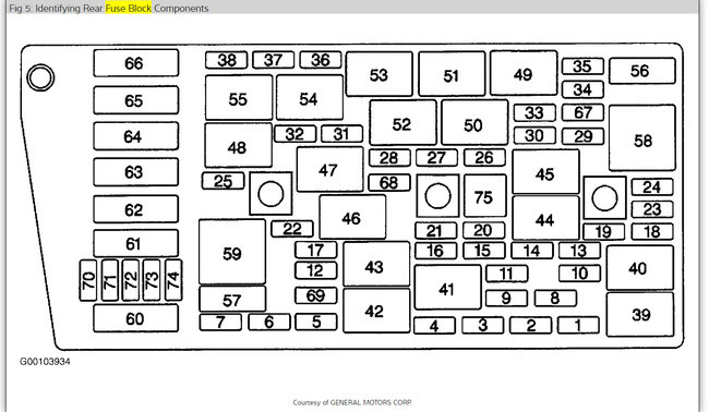

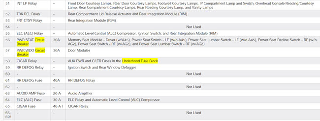

Where are the fuses for the power seats in a 1995 bonneville SSE
BLUELIGHTNIN6
  • 16,542 POSTS
Fuse #3 (25 amp) in the fuse panel

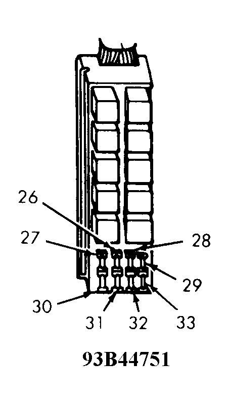

I need to know the complete fuse diagram for a 1993 pontiac bonneville
  • 75,992 POSTS
Fuse & Circuit Breaker Identification
1 - Blank or Spare
2 - Blank or Spare
3 - 10 Amp (1987) Radio; Blank (1988-91)
4 - 25 Amp (1987) Windshield Wiper; Blank (1988); 10 Amp (1989-91) Radio
5 - Blank (1987); 10 Amp (1988) Windshield Wiper; 25 Amp (1989-91) Windshield Wiper
6 - 20 Amp (1987) Cooling Fan Relay; 5 Amp (1988-90); 10 Amp (1990-91 SSE Model) Cooling Fan Relay
7 - 25 Amp; 15 Amp (1990-91 SSE Model) Air Conditioner
8 - Blank (1987); 5 Amp (1988-89) Electronic Brake System (Pump); 5 Amp (1990); 10 Amp (1990-91 SSE Model) Electronic Brake System (Control)
9 - 15 Amp (1987) Electronic Vacuum Regulator Valve (EVRV), Canister Purge, Engine Relays; 5 Amp (1988-89) Electronic Brake System (Control); 5 Amp (1990); 10 Amp (1990-91 SSE Model) Electronic Brake System (Pump)
10 - 20 Amp (1987) Fuel Pump Injectors; 10 Amp (1988-89) Cluster, Oil, Compass; 10 Amp (1990-91) Low Coolant, Compass; Blank (1991 SSE Model)
11 - 20 Amp (1987) Taillights; 20 Amp (1988) Radio, Cigarette Lighter, Underhood Light; 20 Amp (1989-90); 15 Amp (1990-91 SSE Model) Chime, Cigarette Lighter, Radio, Power Antenna
12 - 20 Amp Electronic Ride Control
13 - 20 Amp Stoplights (1987-90), Brake & Hazard Lights
14 - 20 Amp (1987) Radio, Cigarette Lighter, Underhood Lights; 20 Amp (1988-89) Taillights; 20 Amp (1990); 15 Amp (1990-91 SSE Model) License Plate Light
15 - 20 Amp (1987-88) Dome Light; 20 Amp (1989) Courtesy Light, Power Mirror; 20 Amp (1990-91); 15 Amp (1990-91 SSE Model) Courtesy Lights, Power Mirror & Locks
16 - 20 Amp (1987-88) Gauges, Generator Light; 20 Amp (1989) Door Locks, Illuminated Entry System; 20 Amp (1990); 15 Amp (1990-91 SSE Model) Gauges, Illuminated Entry System, Anti-Theft (1991)
17 - 10 Amp Electronic Control Module (ECM), Computer Command Control; 20 Amp (1990-91 SSE Model) Trunk Relay
18 - 5 Amp; 10 Amp (1990-91 SSE Model) Cruise Control
19 - 15 Amp; 20 Amp (1990-91 SSE Model) Turn Signals, Back-Up Light
20 - 20 Amp Electric Trunk & Fuel Door Release; 10 Amp (1991 SSE Model) Instrument Panel Lights
21 - Blank or Spare
22 - Blank or Spare
23 - 30 Amp Circuit Breaker (1987-88) Power Windows; 30 Amp Circuit Breaker (1989-91) Power Windows & Sun Roof
24 - 30 Amp Circuit Breaker (1987-88) Power Seats, Rear Window Defogger; 30 Amp Circuit Breaker (1989-91) Power Seats & Door Locks, Rear Window Defogger
25 - 5 Amp; 10 Amp (1990-91 SSE Model) Instrument Panel Lights (1987-90), Low Coolant (1991), Compass (1991), Driver Information System (1991)
26 - 10 Amp (SSE Model Only) Spare (1988), Radio & Accessories (1989), DIC (1990-91)
27 - 10-Amp (SSE Model Only) DIC (1988-89), Heated Mirrors (1990-91)
28 - 15 Amp (SSE Model Only) Heated Mirrors (1988-89), Courtesy Lights (1990-91)
29 - 20 Amp (SSE Model Only) Spare (1988-89), Horn (1990-91)
30 - 15 Amp (SSE Model Only) Instrument Panel (1988), Engine Relays (1989-91)
31 - 20 Amp (SSE Model Only) Fuel Pump
32 - 10 Amp (SSE Model Only) Injection
