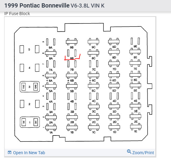

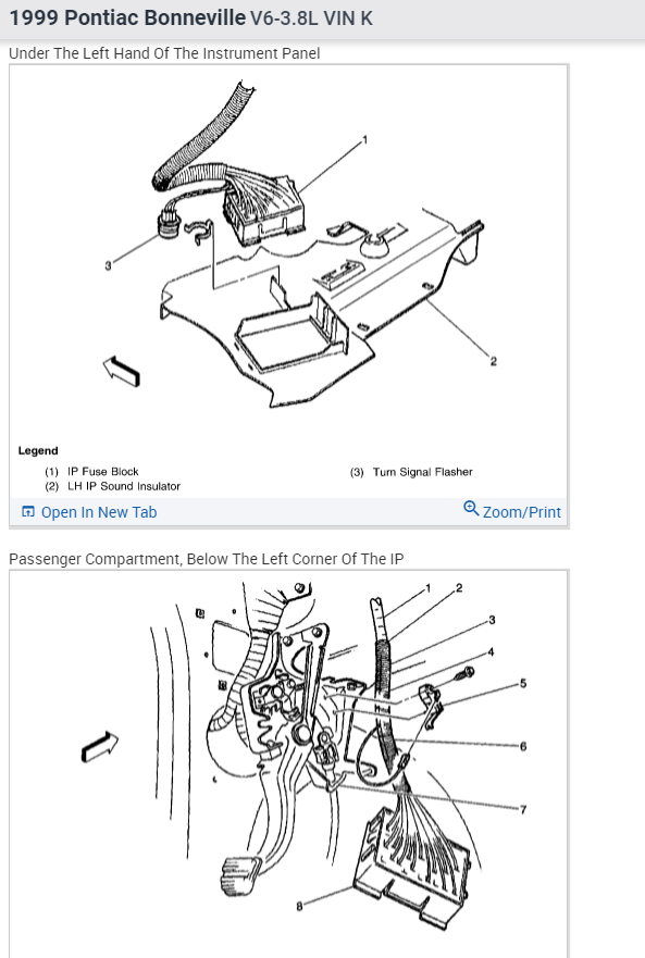

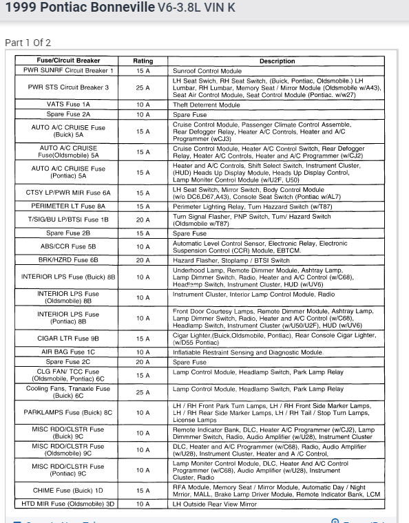

It could be due to a blown fuse or faulty wiring.
First check the fuse. There is a 10A fuse located in the fuse panel under left hand side of the instrument panel.
