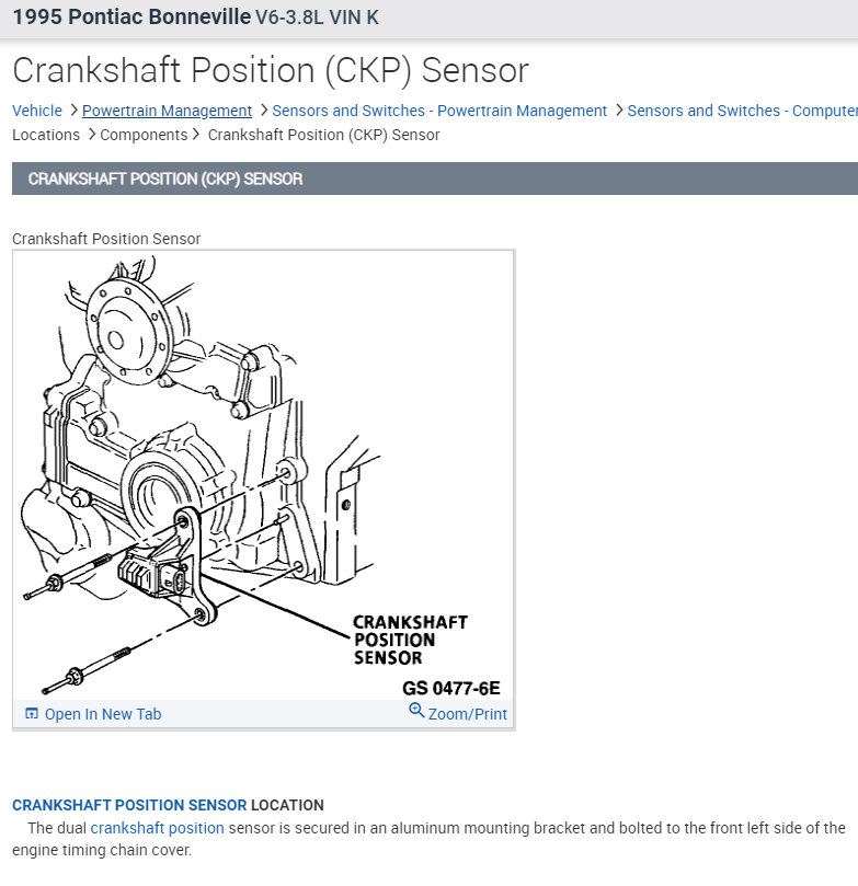

A week ago the car quit after driving about 1/2 mile. Power seat and windows would not work. Mechanic found a short in wiring harness under drivers side kick plate. Drove car home - no trouble. Car sat for the remainder of week. Today daughter took car. Drove about.10 mile and it sputtered and reved sporatically so she parked it. I started to bring home and it did the same thing, stalling several times. I got it to run wihile still sounding like it was missing a bit. Idled to near operating temp and reved a few times then it quit and would not start. Thinking it was perhaps a coil breaking down when warm I let it sit for a couple of hours to cool. Still will not start. I do not think the second prob is related to the first but thought I should mention it. Coil pack, control module? Don't know where to start. Thank you

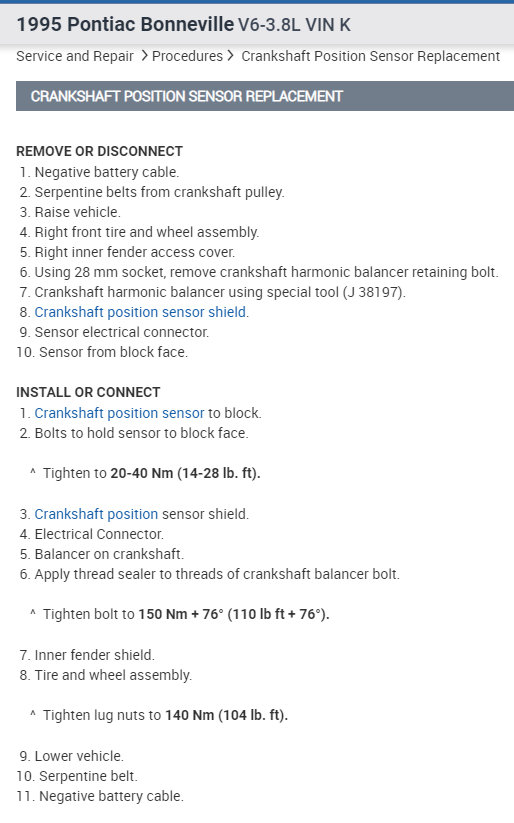

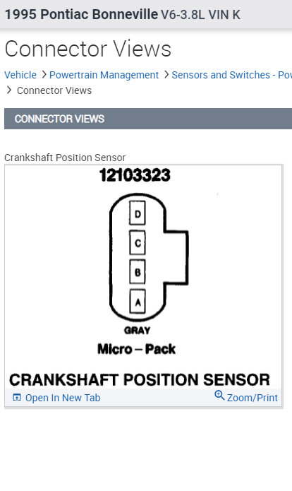

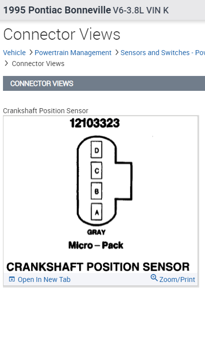

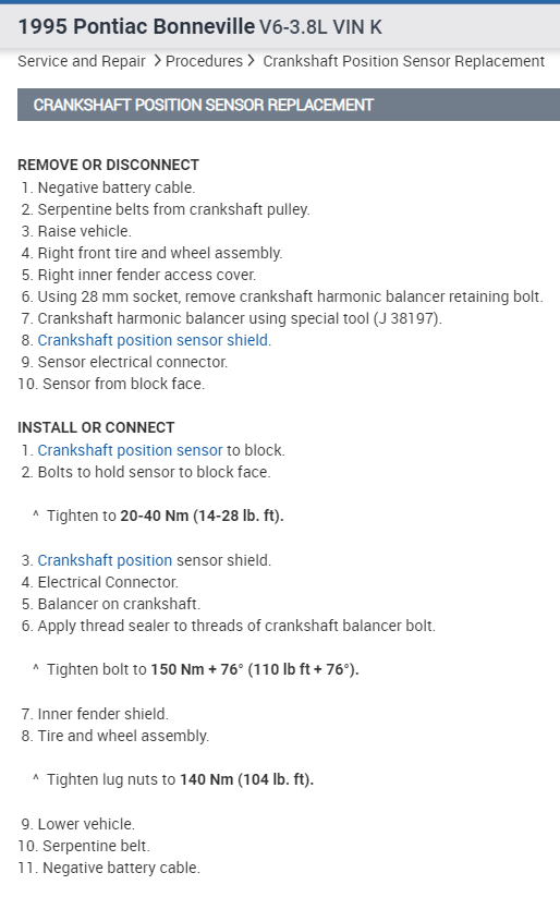

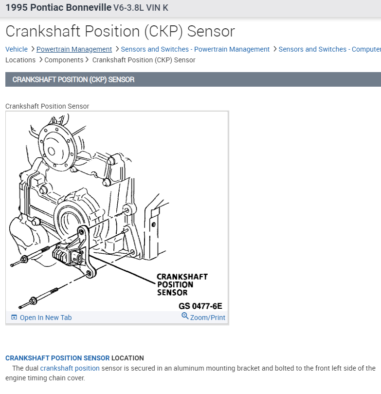

This issue could be due to a faulty crank position sensor.
The crank sensor sends the signal of crankshaft rotation to the ECM. Over time with heat and vibration the sensor can lose its internal calibration and can send error codes. That can trigger the engine to shut down.
The crankshaft position sensor is located next to the crank pulley.
