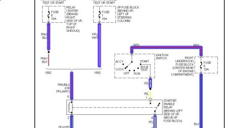

My car wont start. When I turn the ignition to start it all it does is click repeatedly. The starter was replaced in August and the spark plugs was replaced a couple days ago. Could it be something that was replaced like the starter or something else?

Welcome to the forum. I'd have to make sure the battery has a full charge and the connections are good. Next, I'd check the circuit at the starter solenoid, usually a purple wire, that wire goes hot with the key in the start position.
Some of the national brand autostores will test the starter for you. You have to take it off and take it to them.

Could be the starter again who knows -but the following could also cause your problem.
If battery and connectiuons are up to snuff-do below
Have helper hold key in the starting position -check for power at the purple wire on the starter solenoid-not there test the transaxle position switch, starter relay and ignition switch-See Start EWD
https://www.2carpros.com/forum/automotive_pictures/12900_s1_31.jpg
https://www.2carpros.com/forum/automotive_pictures/12900_s2_29.jpg
