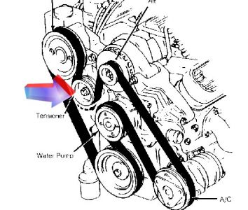

How do you loosen the belt to take off an altenator?

Put a socket on the tensioner pulley and pull it to loosen the tension while you slip off the belt. Ease the tensioner back to rest.
