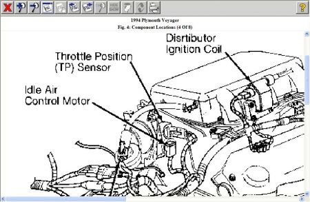

What do the Idle air control motor and throttle position sensor look like and where are they located?

Idle air control motor and the throttle position sensor-See below

Thanks for the picture!
What kind of testing should I do?
Continuety test?
Resistance test?
Voltage test?
Tuesday, March 25th, 2008 AT 8:45 PM
  • 75,992 POSTS
You can perform all 3 of them.
