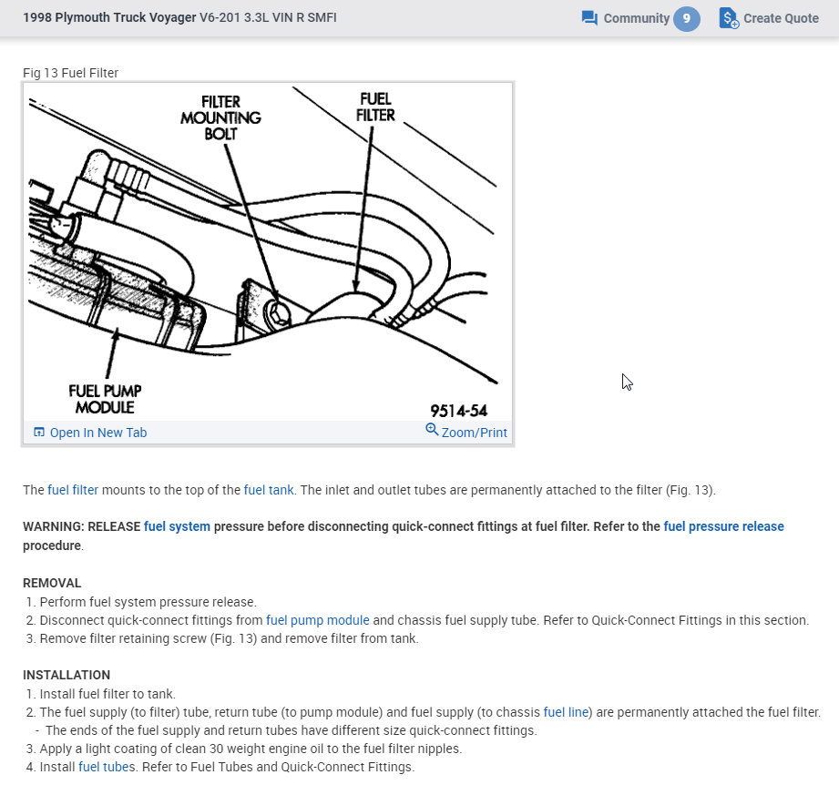

FUEL FILTER
Removal & Installation
Fuel filter is located on top of fuel tank, near fuel pump module. Fuel lines are permanently attached to fuel filter.
Release fuel pressure from fuel system.
Disconnect fuel lines at fuel pump module and fuel supply line using proper procedure. Remove retaining bolt and fuel filter.
To install, reverse removal procedure. Use proper procedure for installing fuel lines. Turn ignition on and check for fuel leaks.

Hi AARON,
I attached the procedure for the filter. It looks like it is on the tank. Please let me know if you need more information. Check out the diagrams (Below). Please let us know if you need anything else to get the problem fixed. Thanks

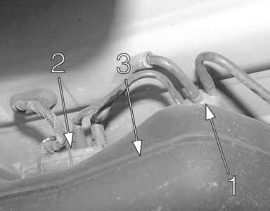

Where is the fuel filter located
Friday, December 25th, 2020 AT 9:19 AM (Merged)
BLUELIGHTNIN6
  • 16,542 POSTS
The fuel filter mounts to the top of the fuel tank, pictured below..
fuel filter (1) mounted next to the fuel pump module (2), on top of the fuel tank (3)
