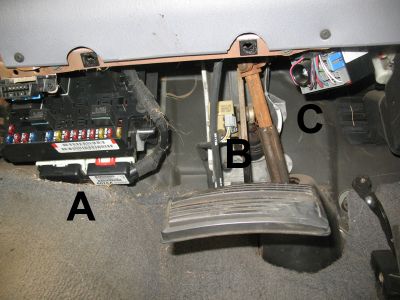

STEVENM2
OK, thanks. I take it that the Body Computer is the item marked "A" in this picture I took just now...I also assume the items "B" and "C" are not it.
How do I get that out of there?

CARADIODOC
  • 34,491 POSTS
It's item "A", but it looks different than I remember from ten years ago workng at the dealership. The plugs on the bottom are connected to the computer, but I remembered it as being in front of the fuses and up higher. There are three 5/16" head bolts holding them together, then you pull the computer straight down to unplug it.
