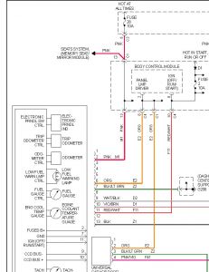

SERVICE WRITER
  • 9,123 POSTS
Unplug the instrument cluster and It very well may start, pretty common with these clusters. They have a couple solder joints that have a problem. Battery replacement seems to create/ expose a problem.

SERVICE WRITER
  • 9,123 POSTS
I just wanted to get in on the quote action
Not tryin to step on any toes, but I ran into this once before after a battery replacement. The cluster ties into the the bcm as the diagram shows....
http://www.2carpros.com/forum/automotive_pictures/30961_01ip_1.jpg
see this post also:
http://www.2carpros.com/forum/electrical-problem-vt44083.html?highlight=
