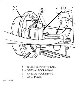

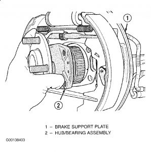

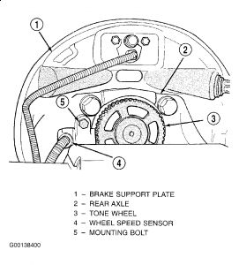

how can you get the back wheel dearing loose I got all the bolt out
Friday, September 18th, 2009 AT 1:38 PM
DOCFIXIT
MECHANIC
18,828 POSTS
Corrision has caused bearing to sieze. May try some PB Blaster and torch to apply heat. special toll maybe needed see figures.
