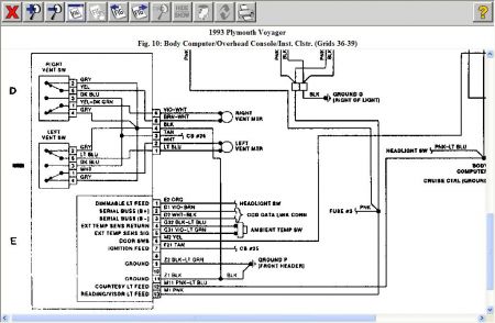

i have a console compass, ice, lights and want to use on another van need to know what the voltages are on the 6 wired plug

Are you refering to the overhead console 6 wire plug?
I have attached a diagram for you to refer. Hope it is the correct one.
Terminal # 3 requires battery voltage and terminal # 4 is the ground. The others are for operations of the vent motors.
