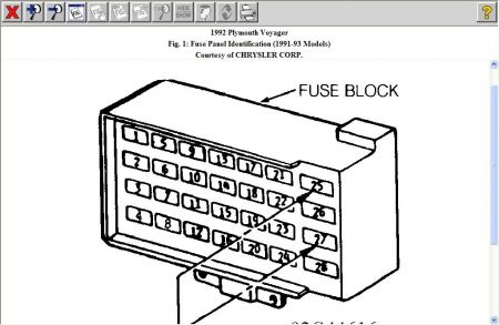

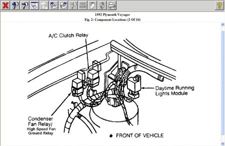

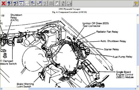

Hi I need to know where the relay and fuse is for the a/c and engine cooling fans. I see a ton of relays under the hoos scattered all over the place and I cant get a manual for this item today

Check fuse no.20 and 26
https://www.2carpros.com/forum/automotive_pictures/12900_fuse_10.jpg
The condenser fan relay is located in the engine bay on right inner fender.
https://www.2carpros.com/forum/automotive_pictures/12900_condenser_and_clutch_relay_1.jpg
Radiator fan relay
https://www.2carpros.com/forum/automotive_pictures/12900_rad_fan_1.jpg
