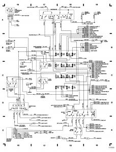

In the 70's Chrysler used a vacuum switch to indicate when the person needed to back off the throttle. When the vacuum would drop in the engine, the left signal light mounted on the top of the fender would light up. I guess that was there idea of a way to improve fuel mileage.
Regardless, in the late 80's the term shows up again, "Fuel Pacer" and it's hooked into the starting system. The only thing I could find is an electrical schematic of how it's wired, nothing on it's purpose. I have made a copy for you to look at while I talk to another mechanic to see if he knows its purpose.
Take a look.... like on a map, go to B-5
https://www.2carpros.com/forum/automotive_pictures/249084_fuel_pacer_1.jpg
I don't know if you will be able to read it because of it's size.
Let me know what you think and I'll keep digging.
Monday, February 2nd, 2009 AT 6:14 PM
AARNOP
No I can not read the schematic. I could only blow it up 150%, which was not enough. I have the Haynes repair manual for the model, but there is nothing in the starting diagram referring to this.
Now when you have identified the F/P, a photo of it would hardly make a difference, or would it?
