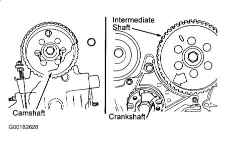

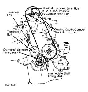

I need where the timing marks are for 88 plymouth reliant 2.5
