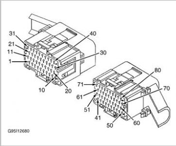

Do you know what pin on the cumputer is for the coil
Thursday, December 31st, 2009 AT 11:36 AM
JDL
  • 16,098 POSTS
My info shows pins 2 & 3 are grounds, one ground for each coil.

BAYDOUNFHS
Thanx again for all the help and info. Im not get any pulse from the cumputer, I replaced the cumputer but im dtill having the same problem no pulse. So far ive replced the coil, crank sensor, cam sensor and the cumputer. What do u thnk now?
Thursday, December 31st, 2009 AT 3:58 PM
JDL
  • 16,098 POSTS
With suspect wiring connectors unplugged on both ends, is there continuity? Our database says if resistance is less than 5 ohms, replace the computer. If over 5 ohms, repair the wiring circuit. If that doesn't help anything, I'm out of ideas.
