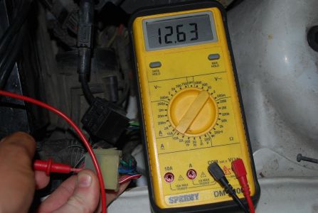

Hi, m still with the same problem: something is wrong in the fuel system. I have another fuel pump and it is working (i cheked it). I checked the dark green and black wire from the fuel pump to the relay and is perfect (i checked it with a tester). i bought a new relay and i already check power in the red wire on the ASD relay and has 12 v. When i turned on the ignition switch, the light blue and yelow wire and the two blue wire has 12 volts but the green and black (fuel pump wire) is with 0 volts.
thats normal? i thought when a relay has voltage, open the circuit for all the pins... in this case not for the green and black wire. What do i need to check now?

OK, right off the bat I see a potential problem with my service manual. The 12 volts all the time on the red wire is proper. My '92 manual shows two red wires for the V-6 engine but only a single red wire for the four cylinder. Still, the 12 volts is correct.
For both engines, my book shows a single dark blue wire where there's two in your photo, and I show two dark blue / yellow wires where you have one. One of those blue wires must be grounded by the Engine Computer to turn the relay on. Make a simple test for me please. Unplug the relay, then remeasure the voltages on those two blue wires. One should have 0 volts now. I would like to correct my service manual but I need to know if the colors are listed incorrectly or if a wire is drawn in the wrong place.

I took a picture of the socket. The pair of blue and dark wires has 12 volts. the other one, the blue with yelow line wire has 0 volts.
now, what do i need to do? thanks willy

That dark blue is correct. It has 12 volts when the ignition switch is in the "run" position. That has been a standard color for Chrysler since the early '70s. When you plug the relay back in, you will see that voltage coming through the coil in the relay and appear on the blue / yellow wire. If you use a jumper wire to ground that wire, you will hear the fuel pump run and / or the hiss of the fuel pressure regulator on the fuel rail.
Put your meter probe into the dark green / black wire so you can monitor the voltage from inside the car. When you first turn on the ignition switch, you should see a quick 12 volts for one second, then it will go back to 0 volts. Sometimes digital meters don't respond fast enough. A test light might work better. Instead, if you can hear the fuel pump run for that one second, you know the relay turned on.
If you see the 12 volts or hear the pump run, the Engine Computer has control of the relay. If not, inspect the blue/ yellow wire back to the Engine Computer's connector. After you get that one second burst, the voltage should appear again during engine cranking. If it does not, suspect the Hall Effect switch pickup assembly under the rotor in the distributor. Its pulses are what tells the Engine Computer to turn on the fuel pump and ASD relays.

Ok, today I did that you told me, I grounded the blue/yellow wire and I heard a click and the green/black wire (fuel pump wire) had 12 volts!
Now, probably we have 2 possibilities: one is the haff effect. The other one is that the blue/yellow wire is broken (the name is open circuit?). You told me few days ago: "Since you have spark, the Hall Effect Switch is working as well as the ASD relay" so maybe the problem is the blue yellow wire. I was trying to find where it go and I think that doesnt go to the haff effect directly. If not, how can I check this wire?

Finally is running! Today I recheck everything again, change the fuel (it was really old) recheck all the connectors and with fuel in the carb just crank with no problem (this car was sitting for 2 years). Before that, I unplugged all the relays minus the fuel pump relay and the car cranked (just few seconds because the starter fluid) so I think that this model is like 1992 maybe fuel pump and ADS is the same relay.
