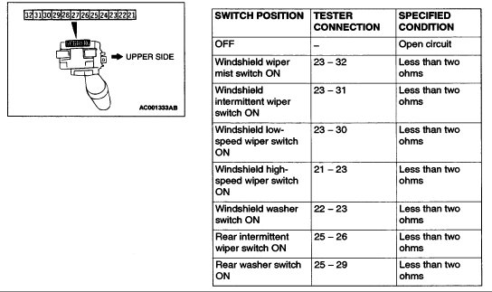

I just got the car today, yes I has high miles. I was not aware of 3/4 of the issues it is having. The car will randomly start shaking stupidly when you are going twenty to thirty five mph. Hit forty mph and it stops. Wiper blades when you click them up it is just suppose to wipe once mine does if seven or eight times then stops whenever it feels like it. I was on interstate car started acting super funny, a tractor trailer flashed their lights at me so I got off at the next exit made it down the ramp car shut off completely (I was about fifteen minutes from home). Car has a funny smell (burning) coming from the exhaust. What causes it to randomly shut off, then turn back on a few minutes later. I need help with some factors it could be so I can take a look at it tomorrow. Also, the car has been sitting for a while.

The wiper issue seems to be switch related. I have attached a flow chart to guide you through checking it. Here are the specs and pin information:
Measure the resistance value at terminal numbers 27 and 28. The resistance value should rise smoothly from approximately less than 2 ohms ("FAST" position) to approximately 1 ohm ("SLOW" position).
