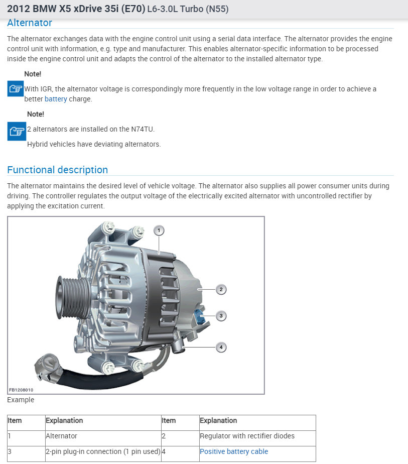

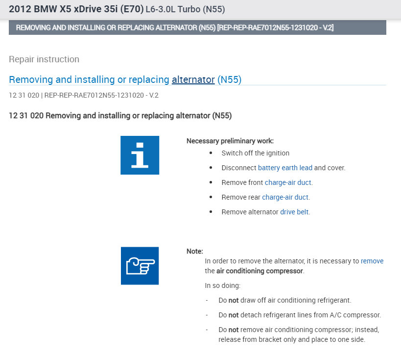

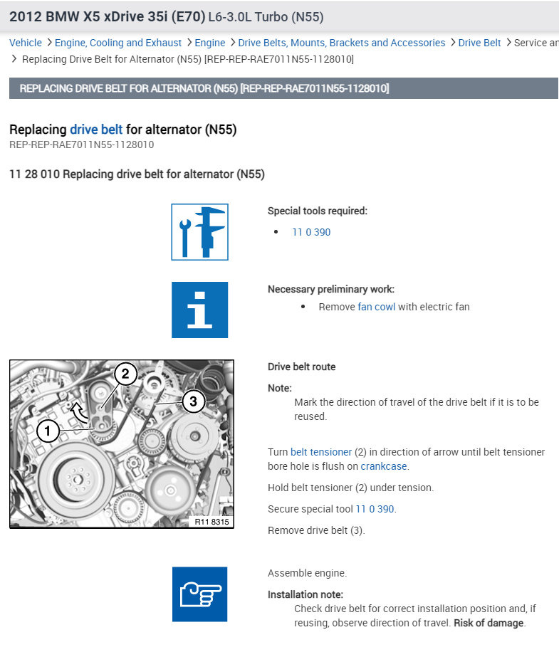

Replacing alternator and have had a hard time with this. It would be the best Christmas present if you could please give me the belt diagram. Thank you

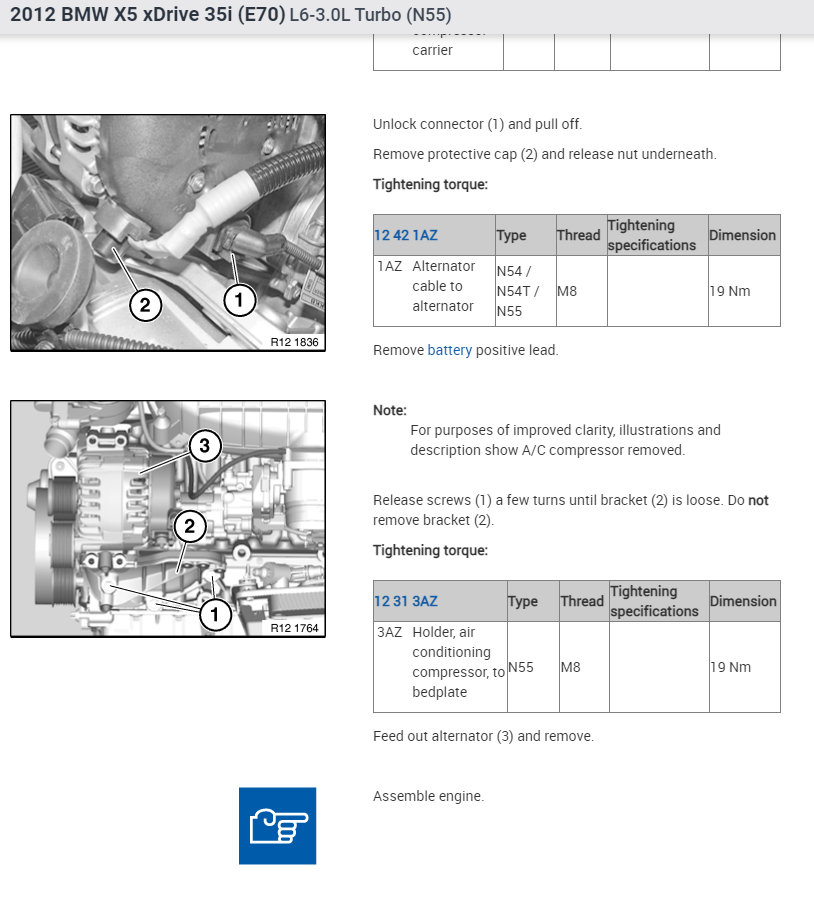

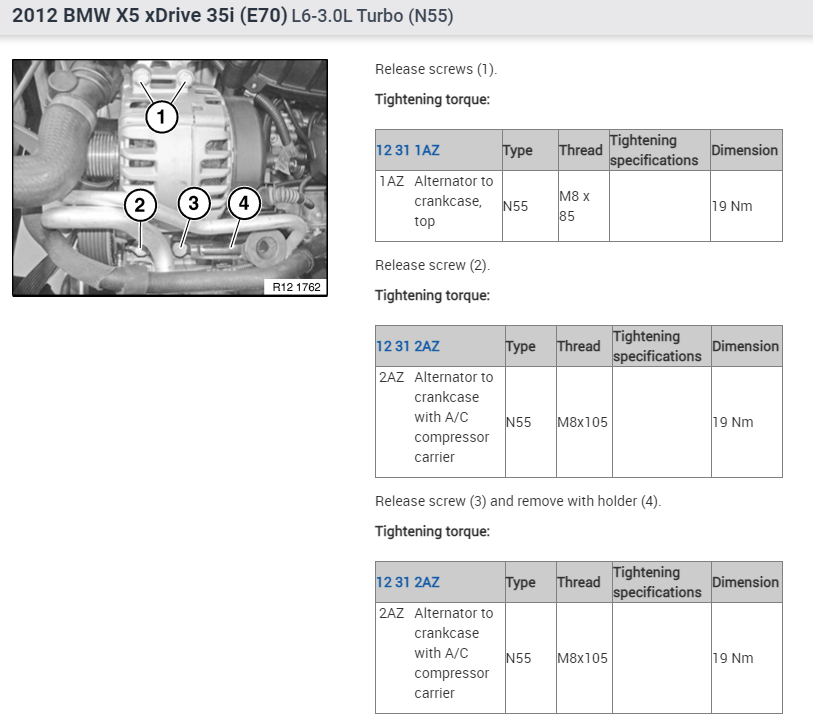

Look below for the belt replacement procedure and the diagram.
Also included the alternator replacement procedure just in case you are looking for that as well.
