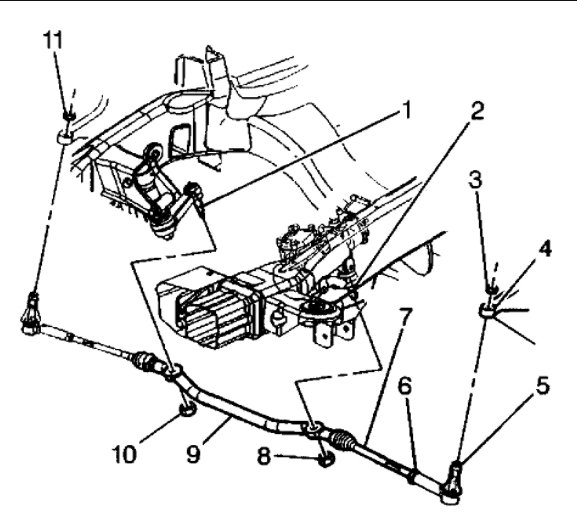

I'm confused . Took my truck in for an alignment and Firestone tech to me needed to replace . Pit-man arm and tie rod ends. Which I did the work myself. But where is the pit-man arm on my vehicle? Couldn't find it or find the Idler arm either. Can you help. Thanks.

Sounds like the tech doesn't know the vehicle which makes me question the rest of the parts needed as well. A pit-man arm and idler arm are are not used on a rack and pinion steering system only on a system with a conventional steering box. That truck could have either system but if they inspected it to find the other worn parts they should have seen which steering system it has and told you the correct parts. What was the issue you took it in for originally? This video will show the job being done

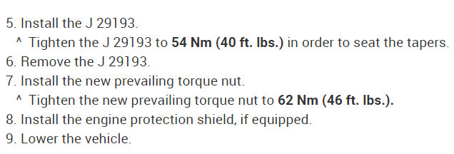

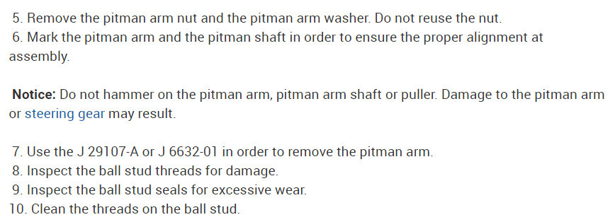

DANNY L
  • 5,648 POSTS
Hello, I'm Danny.

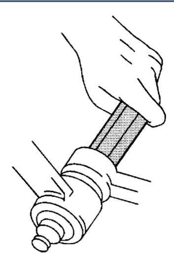

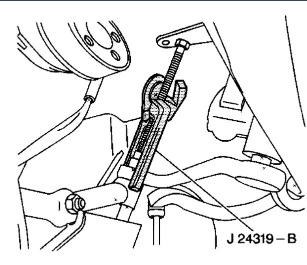

Here is a tutorial showing how to release a ball joint in preparation for pitman arm replacement:
https://www.2carpros.com/articles/how-to-release-a-ball-joint

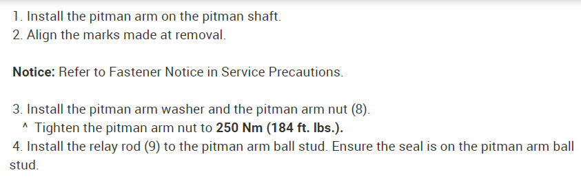

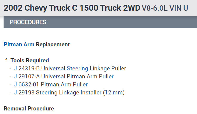

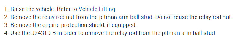

I've attached picture steps below on replacement of the pitman arm on your truck. Hope this helps and thanks again for using 2CarPros.
Jan 4, 2021 at 1:33 PM (Merged)
