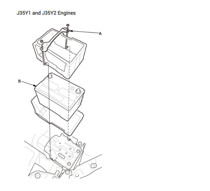

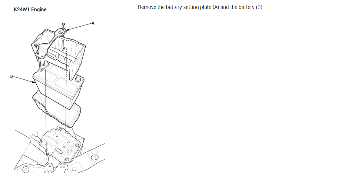

Good afternoon,
I would start by checking the battery voltage. It sounds like you have a low battery.
If you have a voltmeter, check the voltage at the battery. It should be 12.4 to 12.6 for it to start.
+1
Tuesday, May 7th, 2019 AT 4:20 PM
I attached the procedures for replacing the battery for you.
https://www.2carpros.com/articles/how-to-replace-a-car-battery
