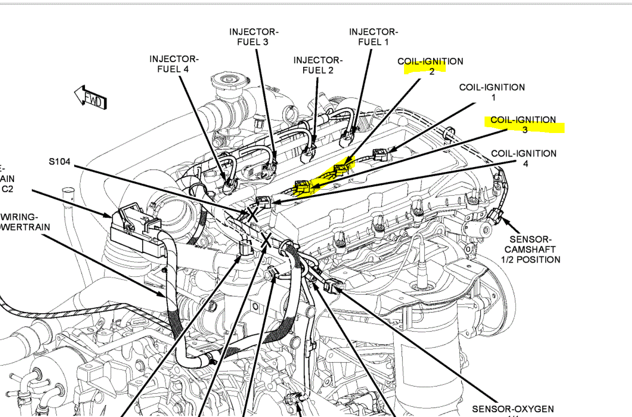

Both of the codes are related. Do me a favor. Switch the cylinder number 3 coil with the number 2 coil. Delete the codes and see if the misfire moves to cylinder 2.
The coil itself may be bad. Let me know the results. Also, I attached a pic below showing cylinder 3 location.

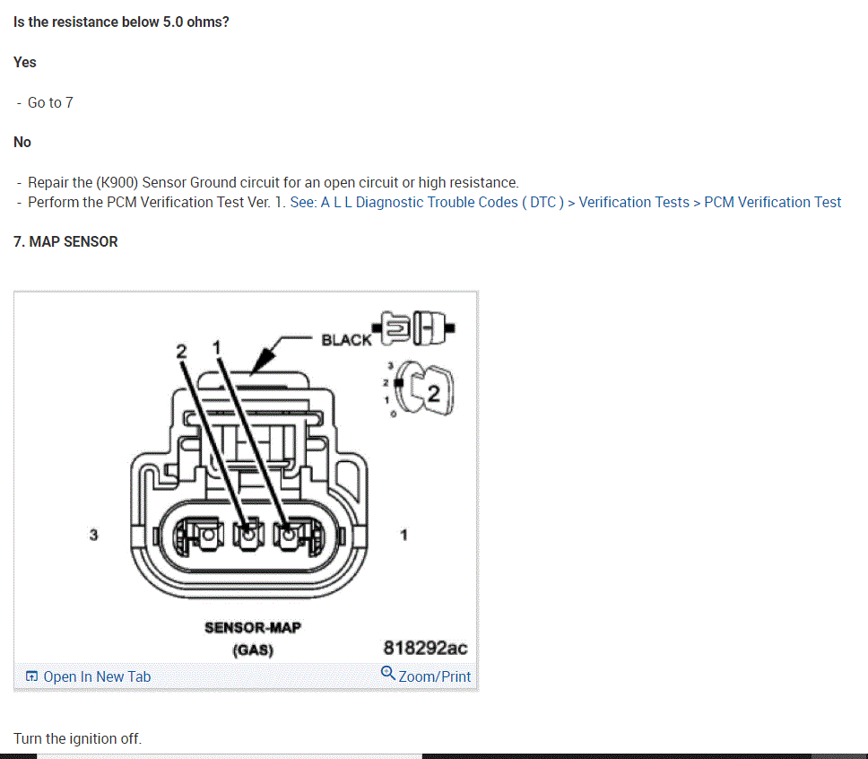

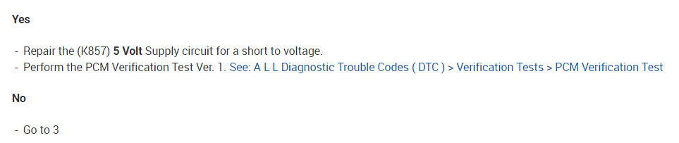

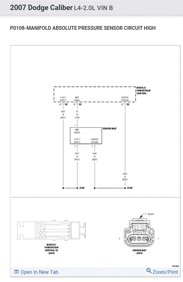

Joe would you like for me to ask a new question? I just was putting on engine cover I had to move the wiring harness out of the way and after driving all day no issues. The engine light came back on and two codes are showing. P0108, P2305. Map and coil. Can't believe it.
JC
Tuesday, August 24th, 2021 AT 4:34 PM

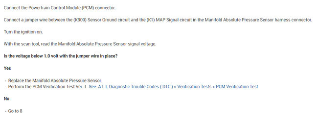

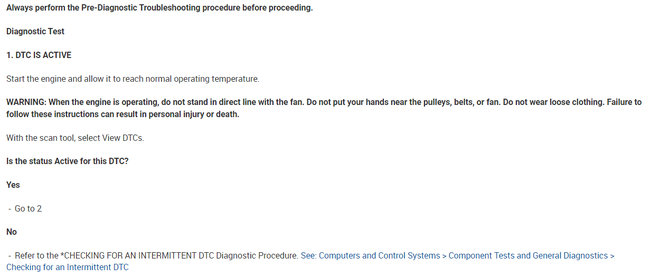

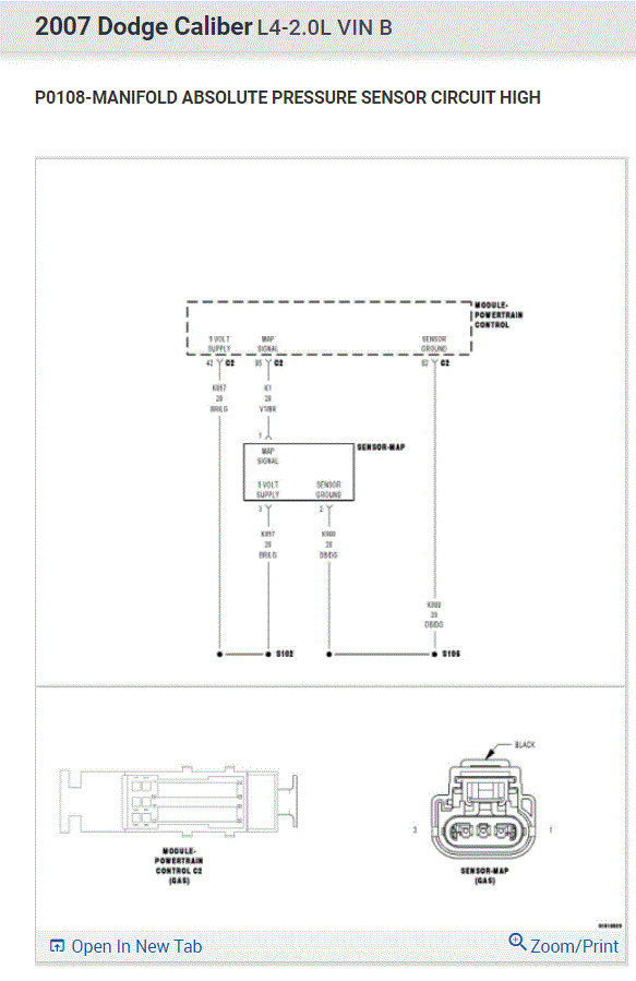

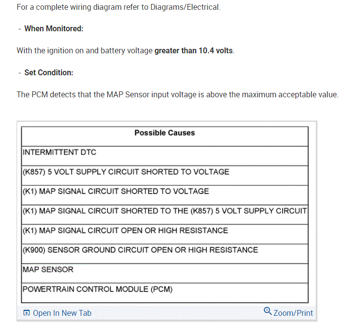

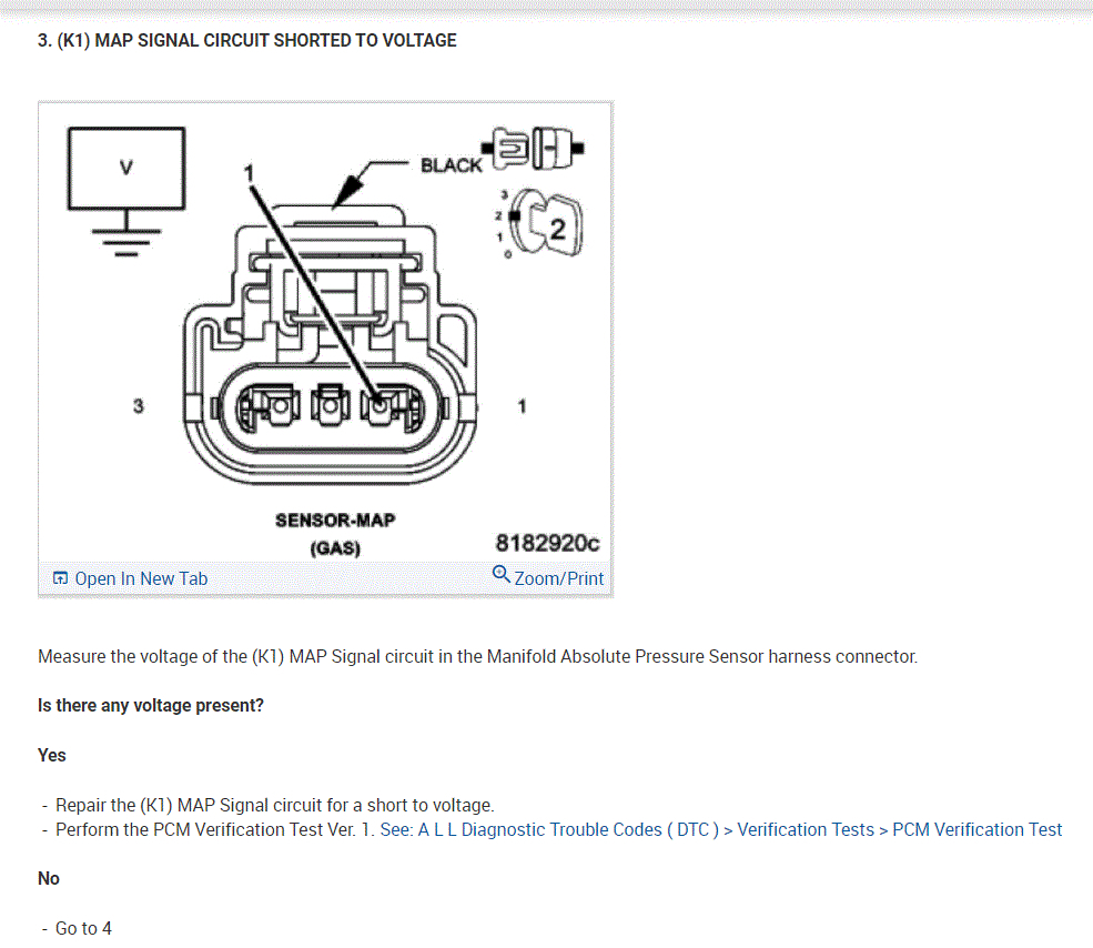

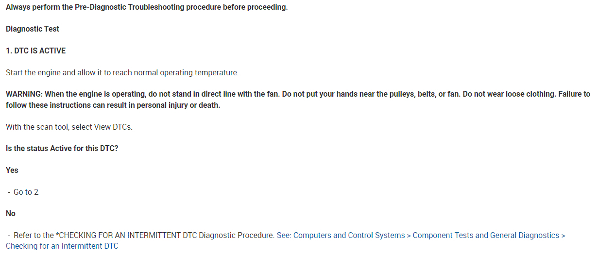

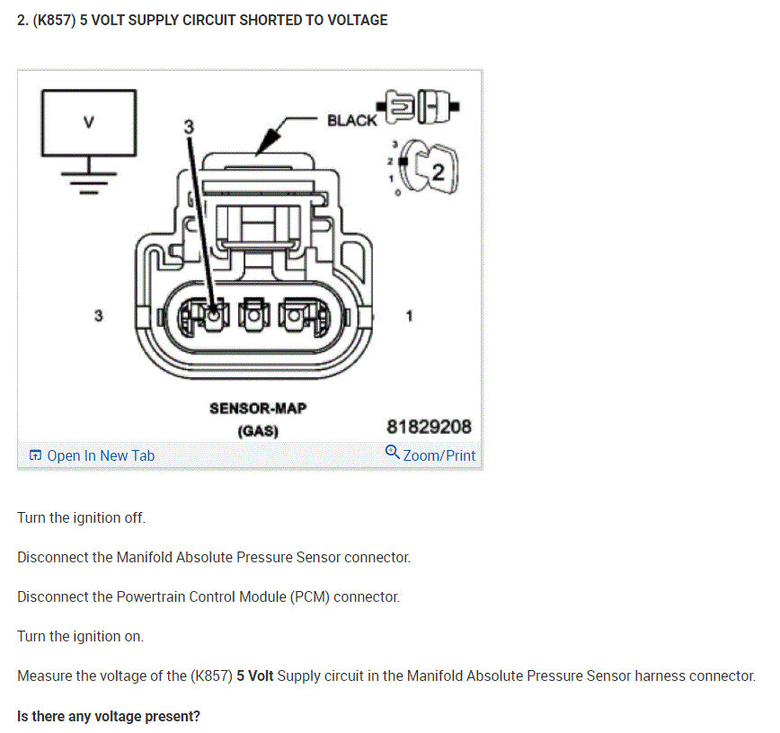

  • 110,192 POSTS
There is no need to start a new one because it is still related to the original issues.

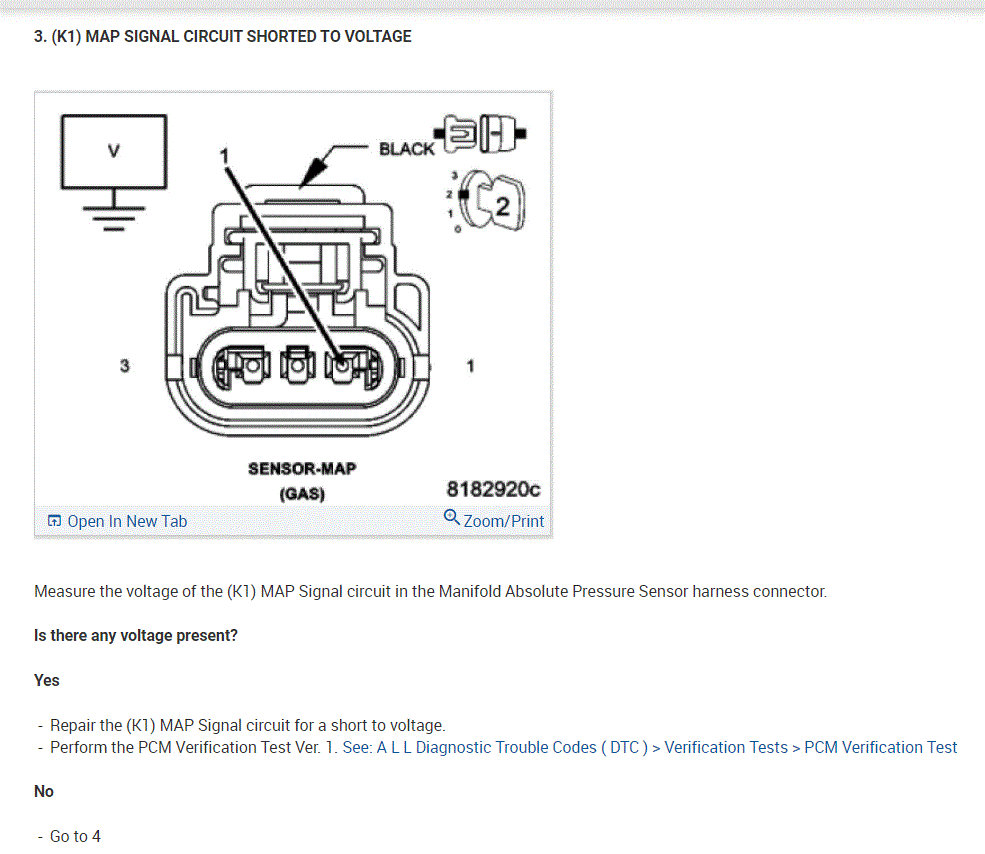

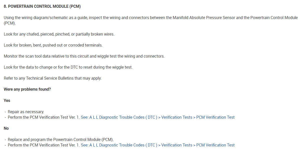

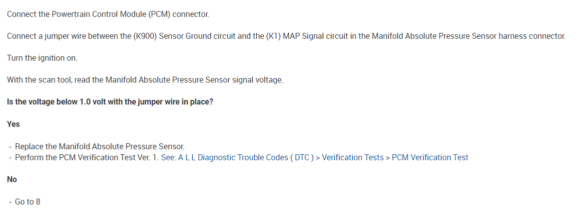

I attached the diagnostics below for the P0108. That is related to the MAP. Lets start with that first.
Go through these diagnostics and then we'll hit the cylinder 2 coil after this. Also, let me know if you feel the misfire and if the check engine light was flashing.
Tuesday, August 24th, 2021 AT 8:01 PM
JC-842
  • 181 POSTS
Check engine light is not flashing. So I moved the wires around and it running smooth again. By the way I just bought the MAP sensor it's new.
Tuesday, August 24th, 2021 AT 8:26 PM
  • 110,192 POSTS
Can you narrow down which wire is causing the change when moved? You must have a bad connection or even an internal break in the wire.
Where did you send the email? I didn't receive it.
Tuesday, August 24th, 2021 AT 9:22 PM
JC-842
  • 181 POSTS
I will test at the harness plug first. I have a tracer tool to find a break. I'll do it in the morning. Thanks Joe
Tuesday, August 24th, 2021 AT 9:28 PM

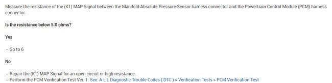

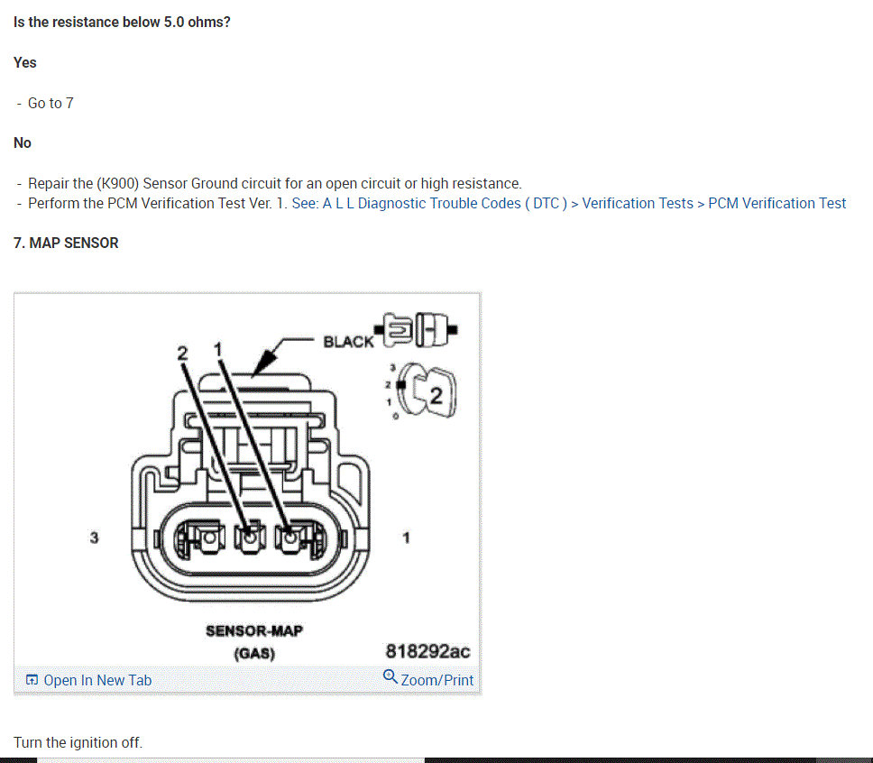

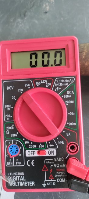

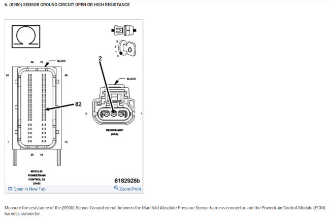

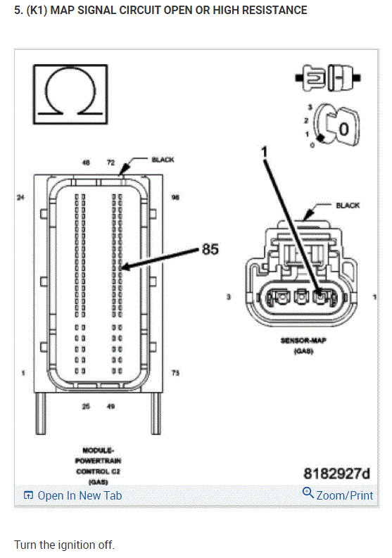

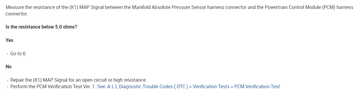

JC-842
  • 181 POSTS

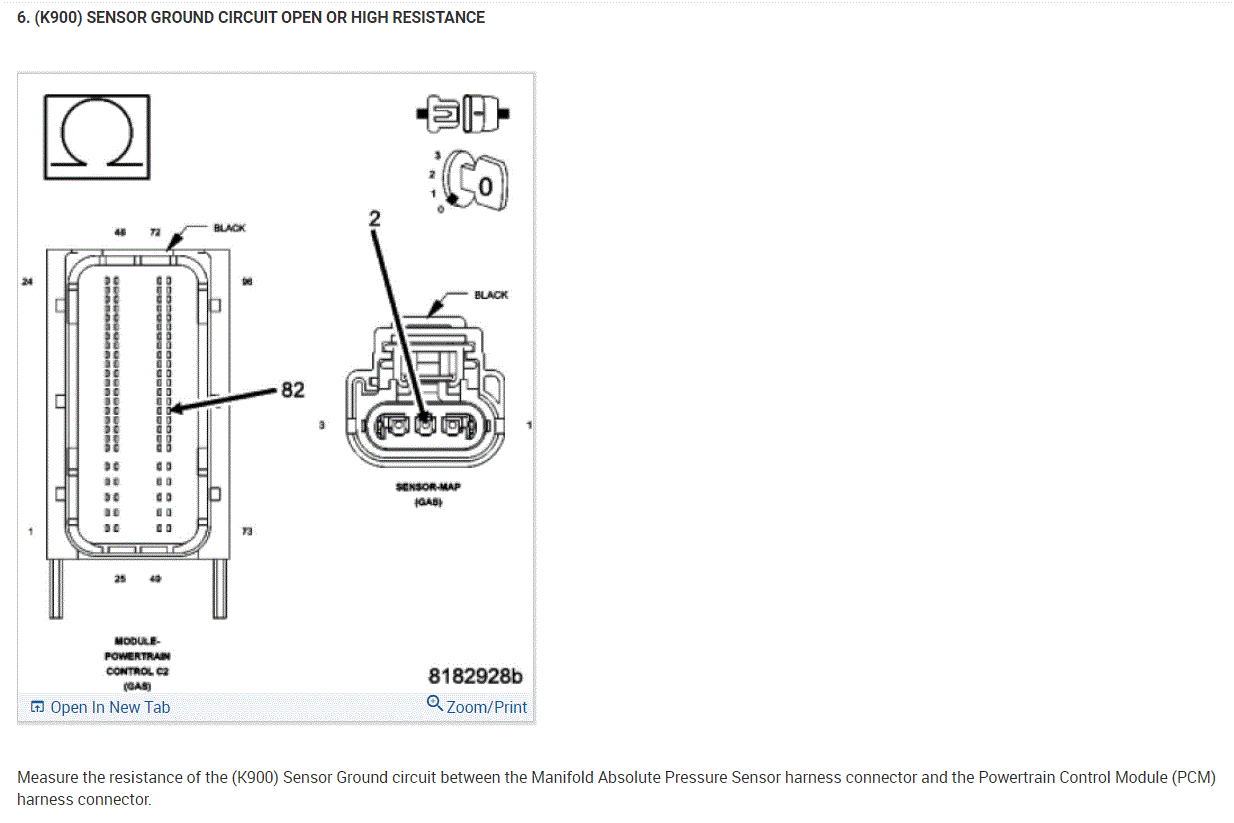

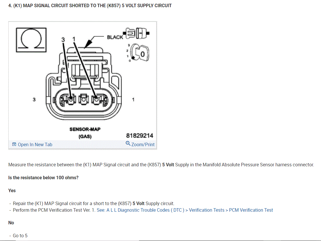

Here's the meter I'm using. Tested steps 3and 4 no 5 volts and also I got no ohm reading. If I'm doing this right. I don't know why this part is so hard for me to figure out. But it is. So I'm assuming there should not be any voltage. And the 100 ohms?
Wednesday, August 25th, 2021 AT 6:30 AM
  • 110,192 POSTS
If you have no voltage and no resistance (continuity), the circuit is open (disconnected). If it wasn't, you would have one or the other.
Check that wire for damage. If nothing is found, move to step 5.
Wednesday, August 25th, 2021 AT 6:11 PM
JC-842
  • 181 POSTS
I had the PCM disconnected per the instructions.
