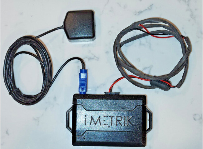

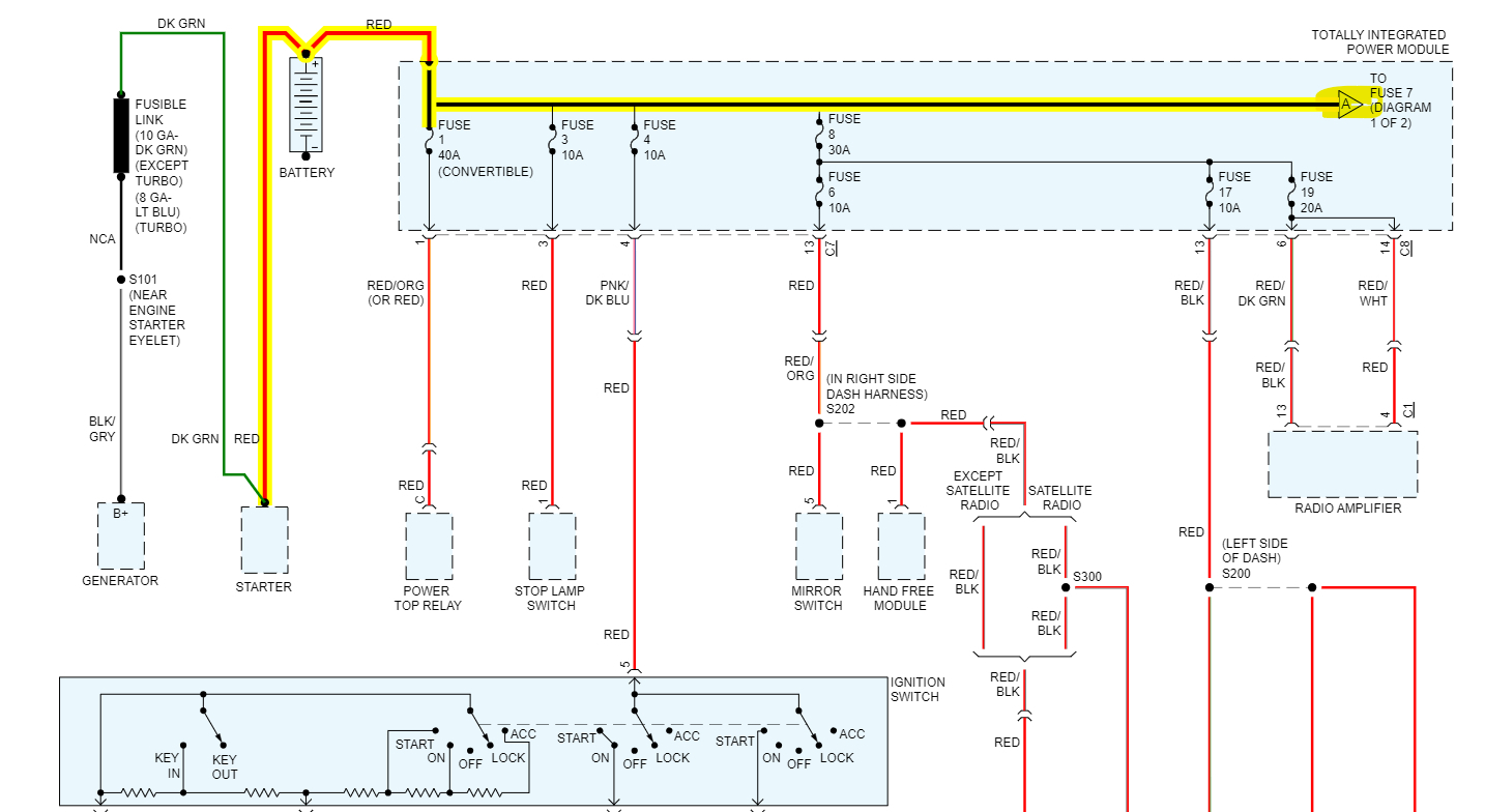

Okay, so the number 1 fuse, is this a Convertible model? I see a number 1 fuse 40Amp, and just so you know, I have seen these vehicles with a ton of electrical problems, So I don't think this is a PCM issue, but if this was the Fuse 1 40amp that was popping, let me know, it's also possible the GPS box was causing a drain. The power and ground wires to that box should have a plug that can be unplugged from the box for now to eliminate that from this issue.

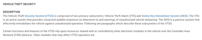

If the theft light is staying on then the security system is activated. The MIL light shouldn't be blinking either, it should come on for about 30sec at key on then go off. This might be an issue with not having the key Fob, you said you only have the grey key so that is probably why it is not allowing you to start. Service info here is telling me that the VTA (Vehicle Theft Alarm) senses when the Battery has been disconnected or failed (low voltage) once reconnected the VTA enters power-up mode, and the Alarm system remains armed. So, it might be the Theft system is causing the no start issue. Service info is also stating that the Theft light flashing you are seeing is the system arming itself. I can't explain why it would be doing this, some of the information here is aftermarket. So, it doesn't give everything, but it does say to disarm the Theft system " a valid Sentry Key Immobilizer System (SKIS) key" must be used. So, I don't know if there is a chip or the correct chip in the grey key you have. But the light blinking and then staying on looks like its arming itself. That would also explain the no spark.
You can try to disable the system; we do have a guide for this. It might work, it might not. But give it a try. You might need to have a couple new key fobs programmed to the vehicle. A locksmith can do this. They have the equipment required for it now. If a programmed key Fob doesn't get it started, at least we will know the Theft system is disarmed.
He will also have a scan tool that can probably tell if the Theft system live data PID says Armed or Not. An advanced scan tool could tell what the different modules are doing. It should be able to tell if there is a key in the ignition switch as well as the status, such as crank, or run.

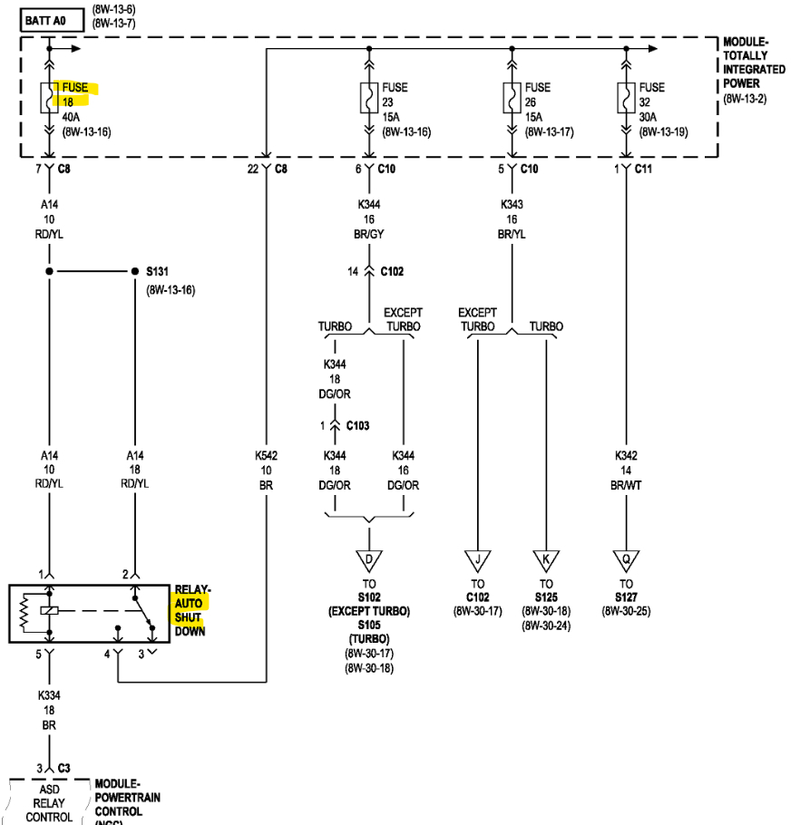

What's odd to me is that power for Fuses 23,26 and 32 all come from the ASD relay being activated. Which means the relay has to be working, but power to the Sentry Key (security system) comes directly from the TIPM. So, the ASD relay might be working but starting is being inhibited still by the security system. Flagship One is a company that sells remained modules, and they offer modules that can have the security system disabled, but it is expensive. So, I would try having some new keys programmed and see if that helps. You need more than a Valet key anyway.

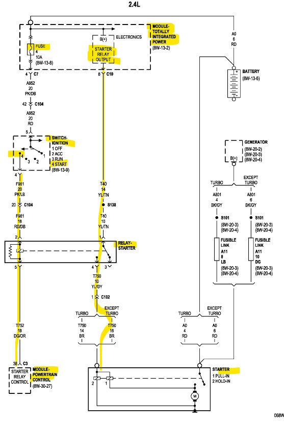

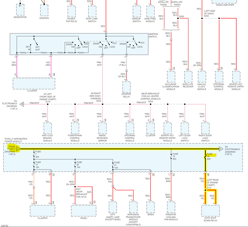

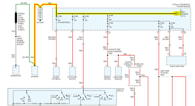

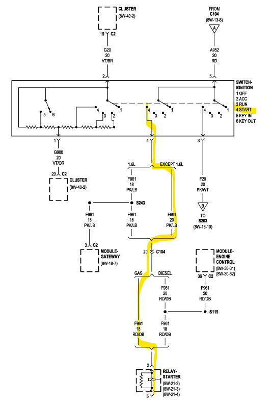

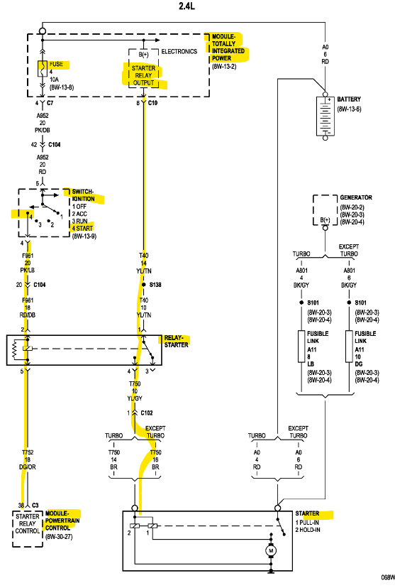

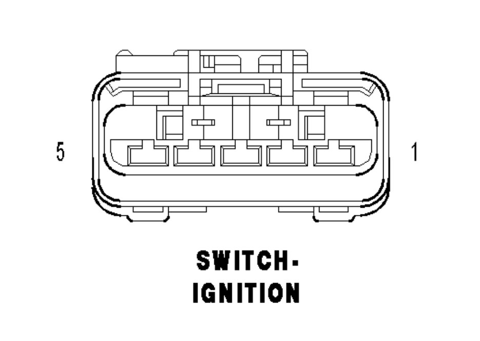

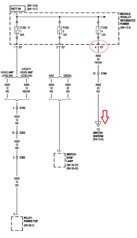

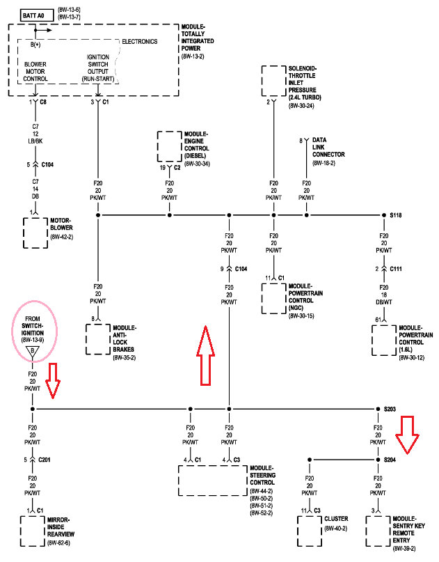

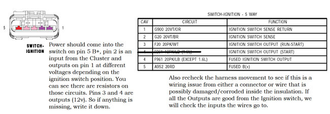

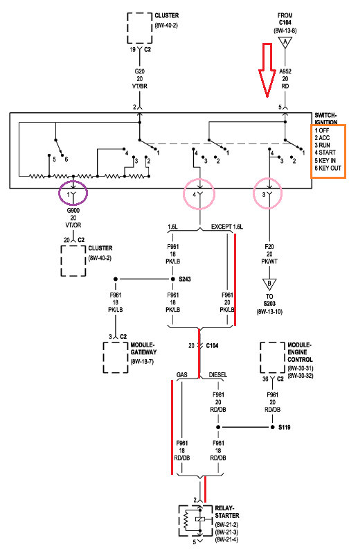

Okay, I went back over the first couple pages of posts, in one of them you had stated you moved some section of harness around below the ignition switch and had some power come back. Diagrams 2,3 below are the OEM wiring diagrams, so let's check that power is coming through the Ignition Switch. Diagrams 5,6 are looking at the Ignition switch connector, so when you look at it plugged in, you'll be looking at it from the back side. Most of the time these connectors are not weather pack with seals, so you should be able to use a multimeter to check the ignition switch plugged in. Since you're only getting a reaction in the Start position, pin 3 might not have voltage coming out. Pin 3 goes to the label output B, which goes to diagram 4 to specific modules.

Hello, I'm sorry I took a few days off from the car but I'm back. so, I'm checking the ignition switch and I get 12.7 volts 0n pin 5 pin four is real lose and the theft light started blinking instead of staying solid and pin 3, I'm getting 12.7 volts. I also had a locksmith come back and program my $180.00 key but said he couldn't because it failed. I don't know what that means, I asked him if he could delete the key immobilizer off my PCM and he said no it wouldn't let him in. please send me a wiring diagram for the starter relay.

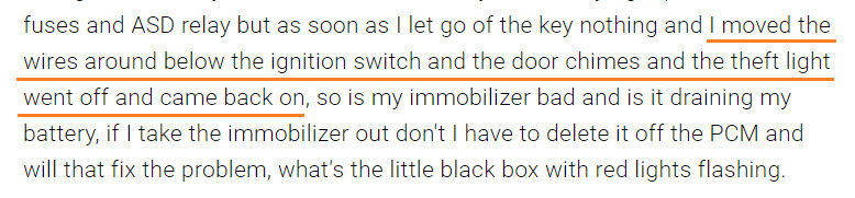

If moving the ignition switch wires around is affecting the security light then you have a connection issue, there's a number of reasons he couldn't program a key, either the key is bad. Which he should have programmed a new key to begin with. Or the power is not waking up modules, you need to make sure all the pins for the ignition switch connector are tight, any loose connectors are not going to help anything, especially the ignition switch.

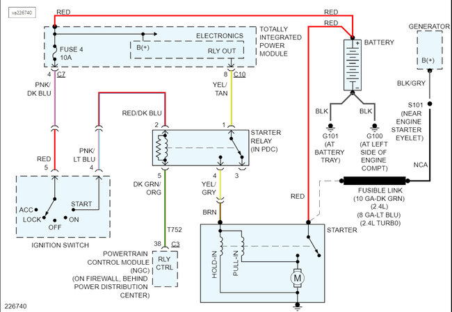

Here's both OEM and aftermarket starting circuits. But the clue here is the change in the security light, I understand this is frustrating, but start with the basics, you know there's a problem with the ignition switch connector. I would even put the old PCM back in, who knows if it's programmed to the correct VIN right now.

It wouldn't be "locked up" with a properly programmed vin, you said you moved the wiring under the dash, and it had an effect on the cluster, so there is a wiring issue there for one. And if you're buying remanufactured cheap PCMs from AutoZone or some place like that, you might not even be getting a decent PCM, most of the time they just repaint them and sell them again. I would concentrate on the wiring under the dash instead of throwing parts at it, you're just going to waste money. You need a scan tool that can tell you if the PCM is seeing the correct inputs from the ignition switch, so buy a decent scan tool that can read live engine data as well as other modules before buying more components. But an Autel MX808, they are a lower end Autel but they can read every module in the vehicle. You can get one for less than $400 right now.
