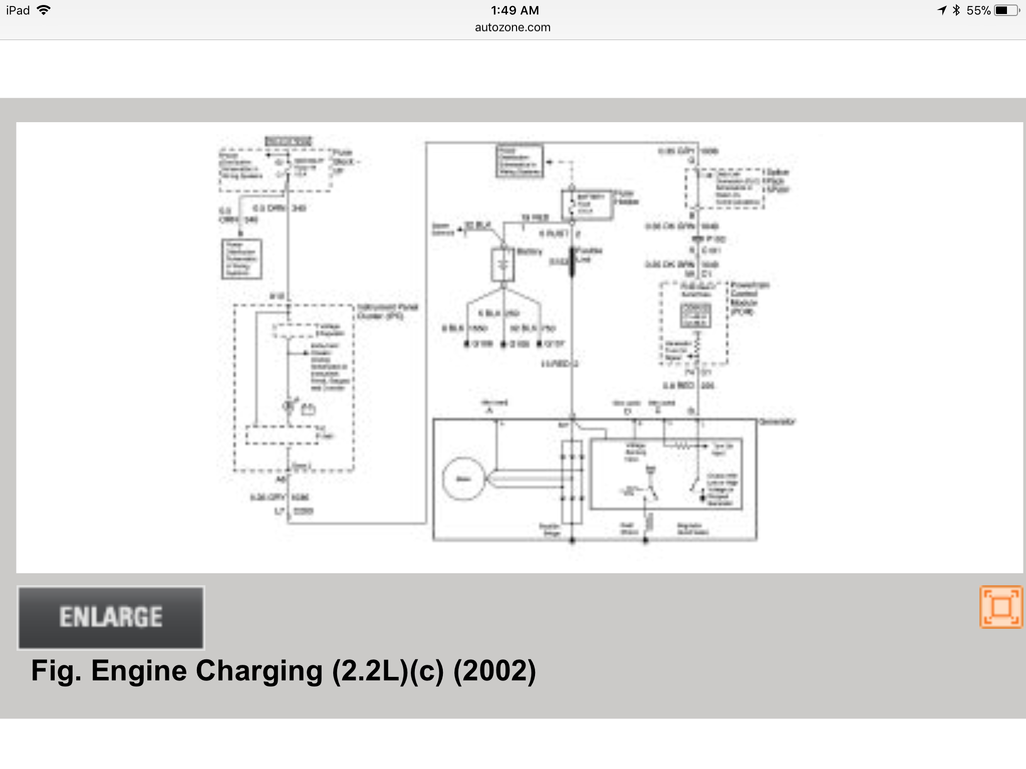

Here is a problem that someone with a true understanding of the GM algorithm and their PCM may be able to help me with.
I am visiting family out of town and I need to resolve this to get back home by the end of next week. This will be a twelve hour drive and I fear breaking down on the highway.
Four days ago my truck listed above (L4) started in a store parking lot and got me to my mom’s home, but the dash and head lights were dimmed, the radio cycled down multiple times and the battery light came on and the dash volt meter showed about ten volts. I verified this with my Fluke 83 DVOM, but had to stop as it was getting dark and starting to rain.
The next morning with meter and amp probe in hand I started the truck up and showed 13.2 volts at the alternator with a 0.075vdp to the battery and a 58.5A draw to run all of the trucks accessories and charge the battery. Within five minutes the voltage rose to 14.1 volts and the amps dropped to 30 amp with most of the accessories turned off.
After shutting down the engine and restarting the truck the battery light, gauge and meter all confirm the truck voltage was 12.2 volts and dropping with no output current from the alternator. I shut down the engine at 11.5 volts . After a few hours the truck was restarted with the alternator’s output returning to normal.
I have been able to duplicate this cycle four times in three days.
After finding and downloading a schematic as best I can determine the single sixteen gauge wire coming off the alternator only tells the alternator “when” to charge and not “how much” as the voltage is a constant 4.70 volts input when the alternator is charging, and drops to less than 1.5 volts when the truck is hot and restarted with no output from the alternator.
My questions are: Am I correct about how this charging system works? Are there any inputs to the PCM that should trigger the PCM to turn off the alternator under these conditions, and what should I look for? Has the PCM fail and can I verify it?

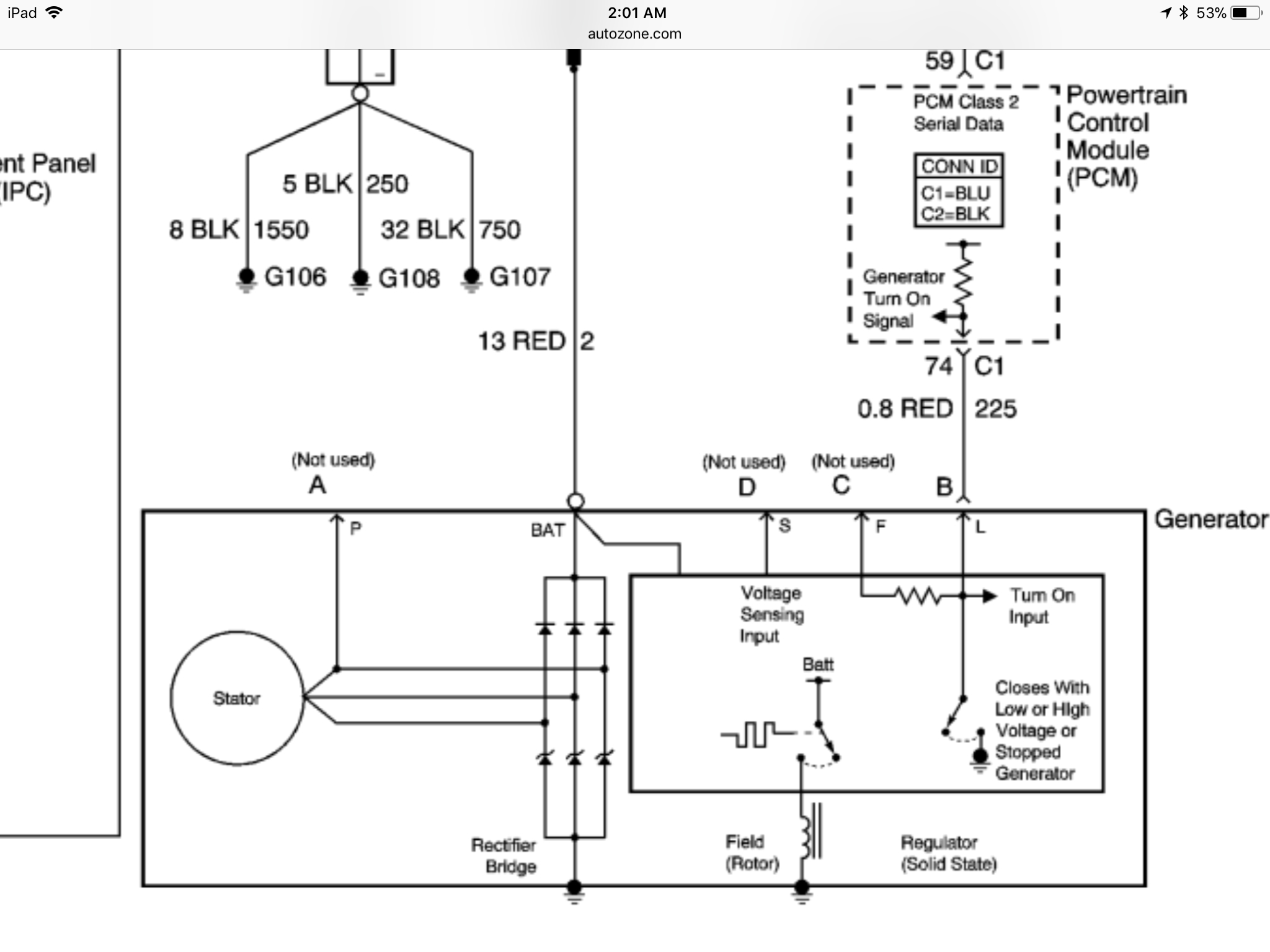

Thanks for the prompt reply. Attached is the wire diagram I receive and used to do my troubleshooting. There is no brown wire on this model. Only the output red wire and a second red wire that runs to pin # 74 C1 of the PCM from the alternator regulator.I am guessing that as with many control module inputs and outputs that this is a five volt circuit and that nominal voltage would be 4.5-5.0v.
When the engine is started cold the PCM is supplying 4.7 volts to the regulator on the alternator, the voltage and amps at the output terminal of the alternator and battery are nominal. The alternator will continue to charge even when hot until the engine is shut down. When the truck is hot the PCM supplied voltage to the alternator drops to 1.5 volts or less and the output of the alternator goes to 0 amp and 0 volts when the truck is restarted. This also happens when this wire is unplugged from the alternator.
Please correct me if I am wrong, but this appears to be a control circuit to activate the alternator. If it is not I would appreciate it if you could explain it for me as I am not familiar with GM’s protocol and programming as all of my training has been with diesels and I have worked as a trainer in this field.
If this does turn out to be a control circuit, is there a reason for a properly functioning PCM to do this or has it failed.

You are still describing a failed voltage regulator. That smaller red wire is still the turn-on circuit. It just comes through more complicated computer circuitry as before. Since the mid to late 1980's, Chrysler has built their regulators into the engine computer so it can adjust for all the variables the computer knows about. Since they invented the electronic regulator for 1970 models, they have always had temperature compensation built in to bump up charging voltage a little when battery temperature was cold. With the regulator built into the computer, it can increase, reduce, or stop output for things like wide-open-throttle, load from the AC compressor, coolant temperature, and things like that.
This is GM's attempt at adjusting output for that variety of conditions. The circuit coming from the PCM is still the turn-on circuit, and the voltage regulator still sends a voltage back to tell the PCM it is working. You are losing that verification voltage. That would be the equivalent on older vehicles of losing the twelve volts it puts on the "battery" light to turn it off.
I am not a fan of testing generators and starters off the engine, especially in this case. The problem does not occur right away, so the unit will test fine. The testing needs to be done while the problem is occurring. That could mean running the test bench for hours.
What you might consider is disconnecting the plug on the generator, then connect a small jumper wire to that terminal that had the red wire. Hook that jumper to a 3057 brake light bulb, and hook the other bulb terminal to the battery's positive post. That will be the dash light bulb. You should see the bulb turn off as soon as the engine starts running. If it turns off when the charging problem occurs, replace the generator.
I have to question though whether there is a significant difference between this generator, which goes back to 1998 models, and the older version that used the dash light. My bulb test will work on the older versions. If it does not work on your model, you will have to go by the loss of feedback voltage.
