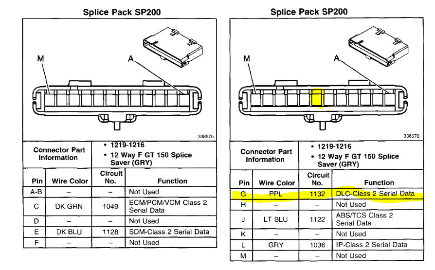

Code reader does not respond to OBDll. The car starts but stops in seconds. PCM?

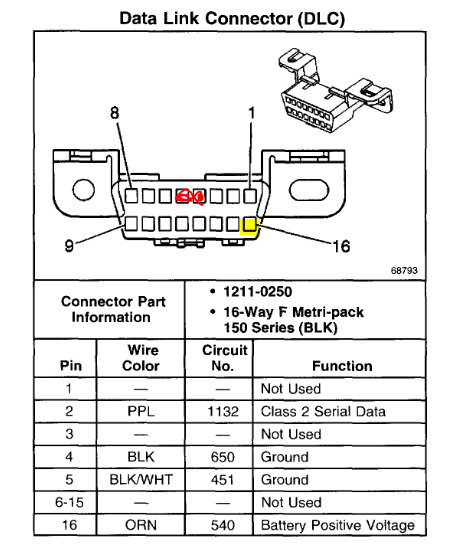

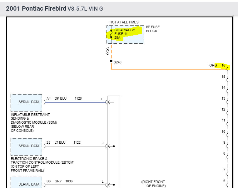

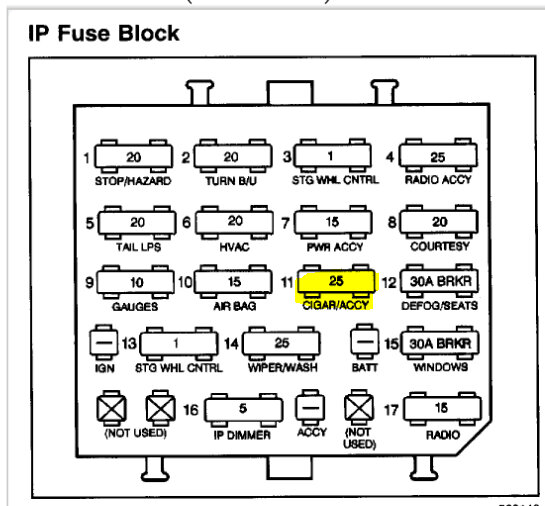

So, here is where we need to start. First, why doesn't the scan tool connect? If you look at the pic below, check pin 16 (highlighted with yellow) for B+ voltage. If that is good, confirm pins 4 and 5 have continuity to ground. Note: If there is no continuity, try it with the key in the on position/engine off.

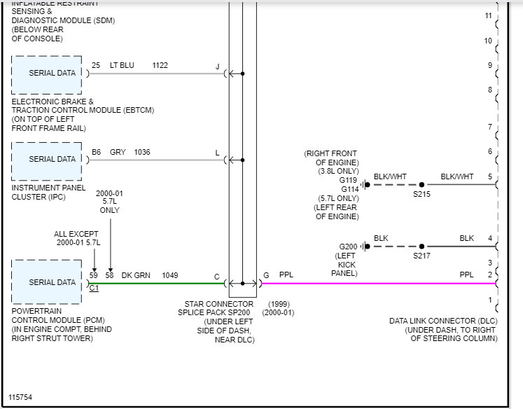

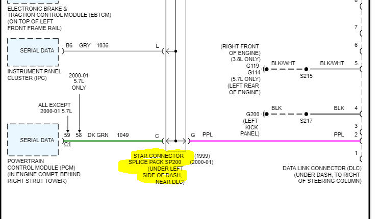

The last two pics are of the computer data lines. Note Fuse 11 in the interior fuse box which is for the cigarette lighter as well as powering pin 16 on the DLC, needs to be checked (see last pic for location). In addition to checking the fuse, make sure there is power to and from it.

Thank you for taking the time to help. Not sure if it’s been 2 or 3 years since it ran for more than seconds. The first thing I did was new fuel filter, no change. Next checked fuel pressure and it had over 50 PSI. I thought it was good put new fuel pump in anyway. No change. When I took the gas tank out something had been chewing on wires. I think repaired wires and new pump worked fine. No change. Took the key to dealer and had resistance checked. He thought it was okay. I bought a new key and cylinder. No change. Just checked pin 16 has power and 2 good grounds. Can computer be taken out and scanned? Need some codes.

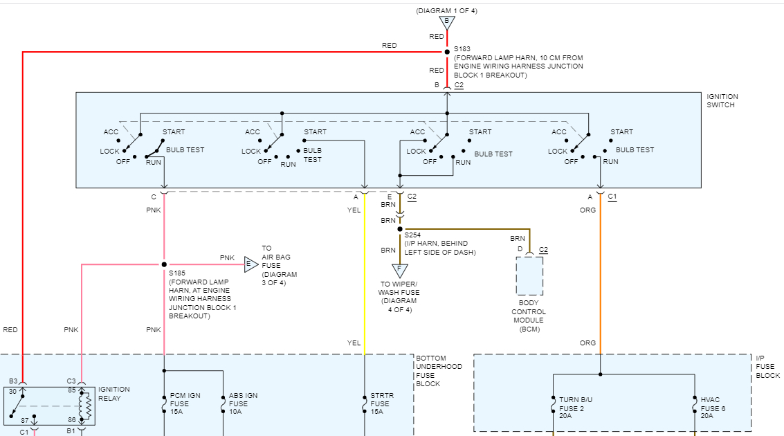

Want to thank you again for your help. Does the ignition switch come with a long orange wire that comes out bottom of steering column, and a place to put key. Security light comes on briefly and then goes out. Starts briefly and stops again and again. When it stops all the gauges bounce back and forth. Act’s like it’s out of gas. Got a new code reader. Power’s up but no communication. Pins to power and 2 grounds good could pin to data port be bad. Should I try to follow purple link wire. Does wire go to BCM or PCM. Tried resetting the computer by removing PCM battery and ign fuses for 20 minutes. I don't like the thought of having it towed to the dealer.

One of the wires from the ignition switch is orange. When you have the key in the run position, it sends power to fuses in the IP fuse box. I attached a pic below so you can reference what I am saying.

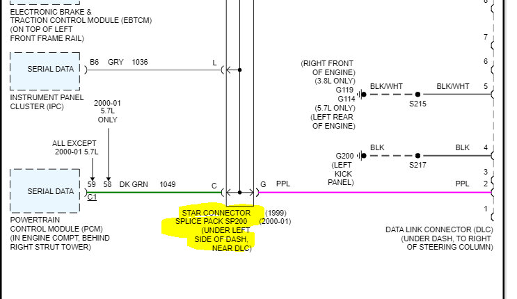

The purple wire goes to a splice pack under the dash on the left side which ties with the PCM. See pic 2 below.
